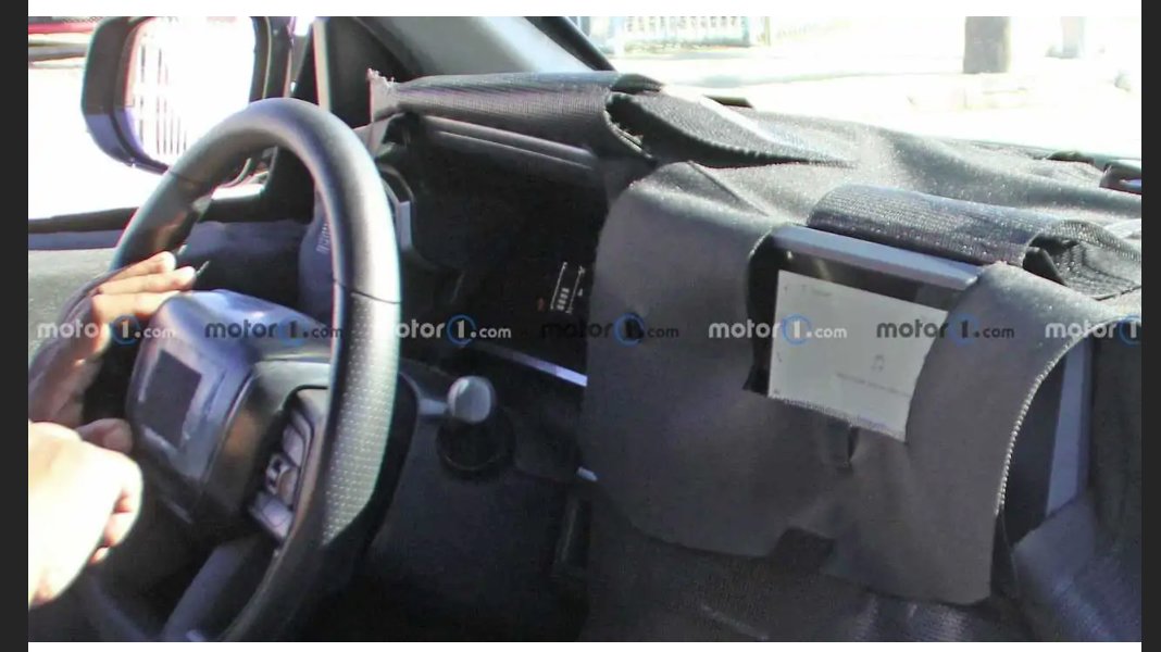

    ktbell444
    ktbell444 One who throws exceptions
    Aug 8, 2017
    #226306
    2,969
    ᚺᛖᛚᚺᛖᛁᛗ
    Well, for starters, I'm sure some would like an updated button set.
