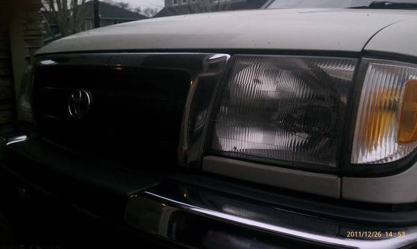

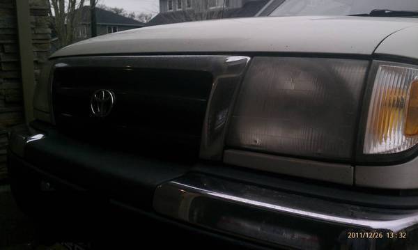

    I've done mine twice now.
    The 3M kit (or any for that matter with different levels of grit and a polish) will work great. The only issue is properly sealing them as the final step. The 3M kit does not come with a clear coat/sealer, so the first time I restored my headlights they eventually yellowed/hazed within months.
    This past weekend I restored them again and sprayed on some Blue Magic headlight clear coat/sealer. Only time will tell if it works or not.

    I am a huge fan of the Mother's kit. I've done two different sets of headlights now and they turned out flawless! After the initial buffing you simply reapply the wax every month or so to keep it clear.

    1000 grit wet sand paper,descent amount of pressure, sand sand sand! I went until I was seeing yellow/white water running off the lights.
    2000 grit wet sand paper, again sand sand sand!
    clean with water and dry them, then I used Meguiar's "plastix" with a buffing wheel, the more you sand and buff the nicer they will be, i didnt think to seal mine up, so as the other guys stated I would do that as well.
