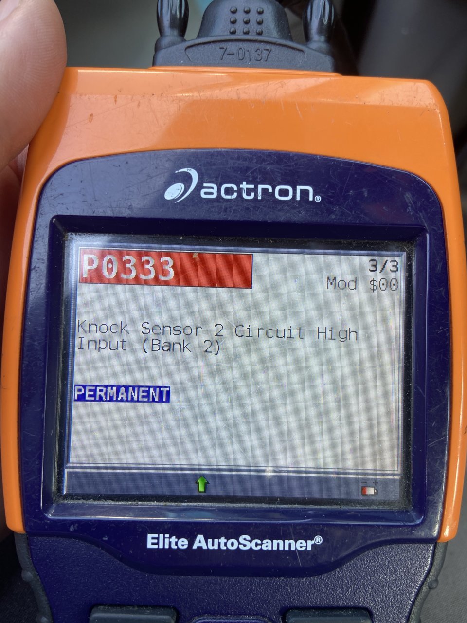

    Girlfriend’s 4Runner with the 4.0 has thrown the traction control light and check engine light, when I ran the code it was indicating the knock sensor was faulty. My jaw dropped when I saw the 20 hour estimate for doing the sensors by the book, but there was mention of people replacing the sensors and harness without having to take the heads off , by instead cutting the bracket that holds the coolant pipes that are obstructing the sensors from being easily removed. If anyone has done this, seen any videos or threads with this or knows a guy who has I would love all the information possible. Thank you

    Hey I'm one who cut the bracket holding the coolant pipes together to remove. I reinstalled without reconnecting the cut metal tab bracket and its been about 3 years now and no leaks. I was on another thread I'll try to find it, had some good info in it. I replaced both knock sensors and harness since i was so far into it. I used my M12 sawzall with short hacksaw blade and took my time cutting the tab that holds the two pipes together. It's aluminum but doesn't cut as easily as I thought it would.
    Here it is:
    https://www.tacomaworld.com/threads...p0333-diy-knock-sensor-harness-repair.547066/

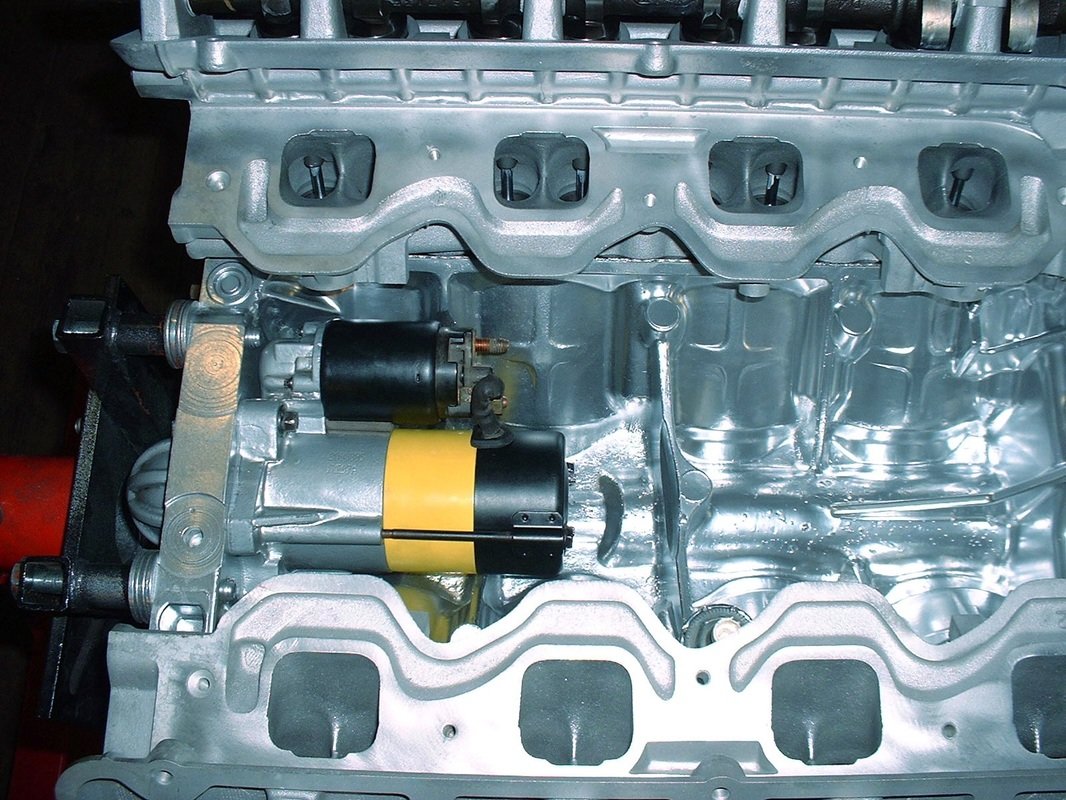

    I think that one flunked. Who TF decided that was a good place for a starter...? Especially with cars that shut off at lights, starters aren't going to last as long with the workout their getting.
    What motor is that out of? So I know to steer ppl away from it....

    Cadillac did it. I’m not sure if there’s other engines like that.
  14. Jul 7, 2020 at 7:22 AM
    TireFire
    TireFire Superunknown Member
    Feb 6, 2016
    #177349
    7,667
    Olympic Peninsula
    Toyota put the starter in the same spot on the 4.7L V8 and possibly others

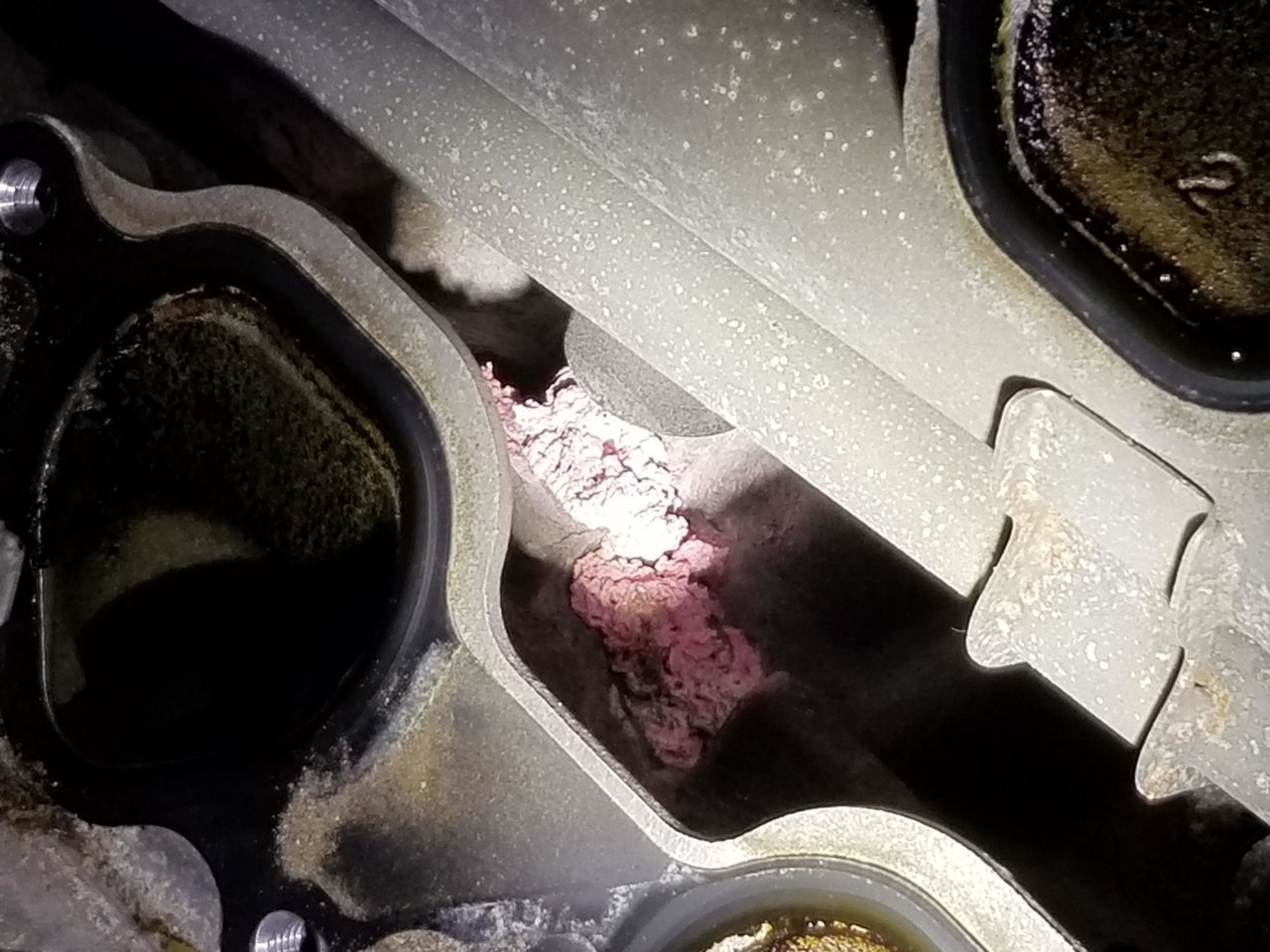

    We had an explosion of mice around here a few years ago and quite a few knock sensor wiring issues. Yum, yum that soy wire insulation + warm place to hang out on a cold night.......
    But I digress. Yes it can be done without removing the heads. Since I never ever wanted to go back in there again I stuffed that area of the 'V' under the pipe with bronze wool. Mice will not go near it. Not a problem with shorts occurring if you just keep it away a little, besides the connectors are not open.
