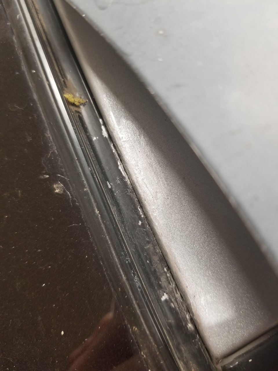

    Have the same issue on my 09 and I think that the rubber seal is to big and is rubbing on the metal.
    I removed the rust with the tip of a flathead screwdriver and painted over it. Have to see how long it will last.
    Maybe shortening the rubber lip with a razor blade a little bit will prevent it from happening again.
