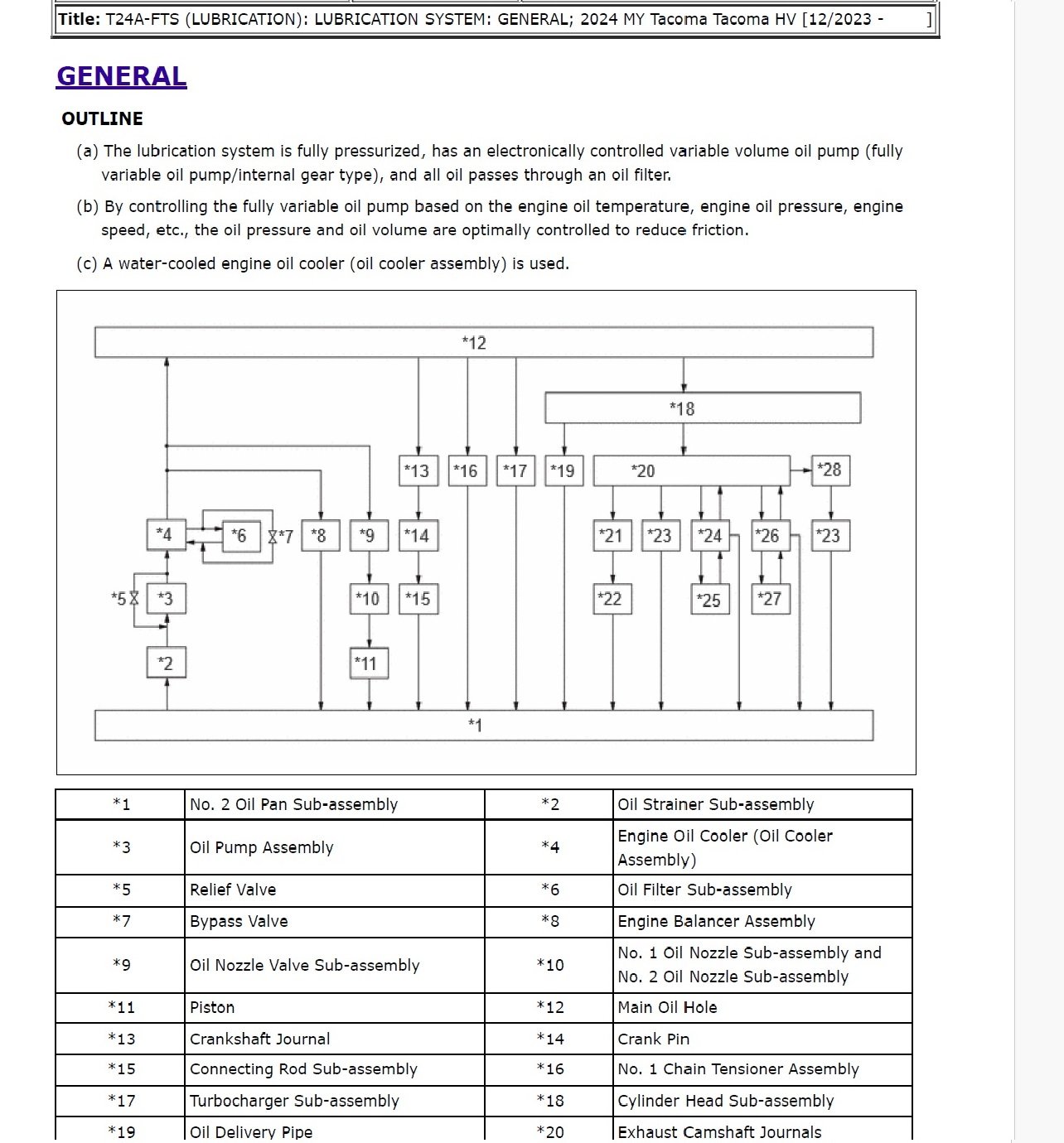

    I am confused. Are we talking about the 4G Taco or the Chevy not having an intercooler/oil cooling?

    I'm wrong. The SR has the intercooler but not the oil cooler.

    Turbo information

    I must be misunderstanding. The turbo on all versions are both air and oil cooled. You must be talking about a cooler for the oil system?

    Correct.

    BTW, it only shares ~ 50 percent of parts with the similar Highlander engine. 50 percent more duty life on the different parts.

    As I stated above, I was wrong. They all have the intercooler. The SR doesn't have an oil cooler.
