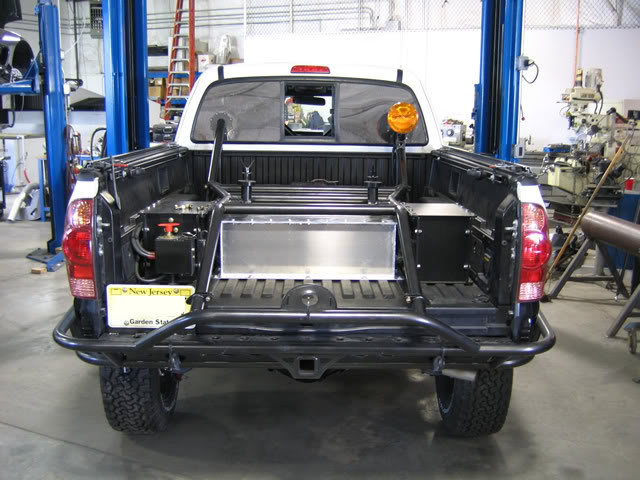

    I've got a kill switch on mine but it's for safety rather than security. Check the driver's side battery box in the bed:
    It's a 600 amp switch. I could winch through this thing if I had to.
    You could install one of these under your hood and disable the whole truck if you were to leave it unattended for any length of time.
