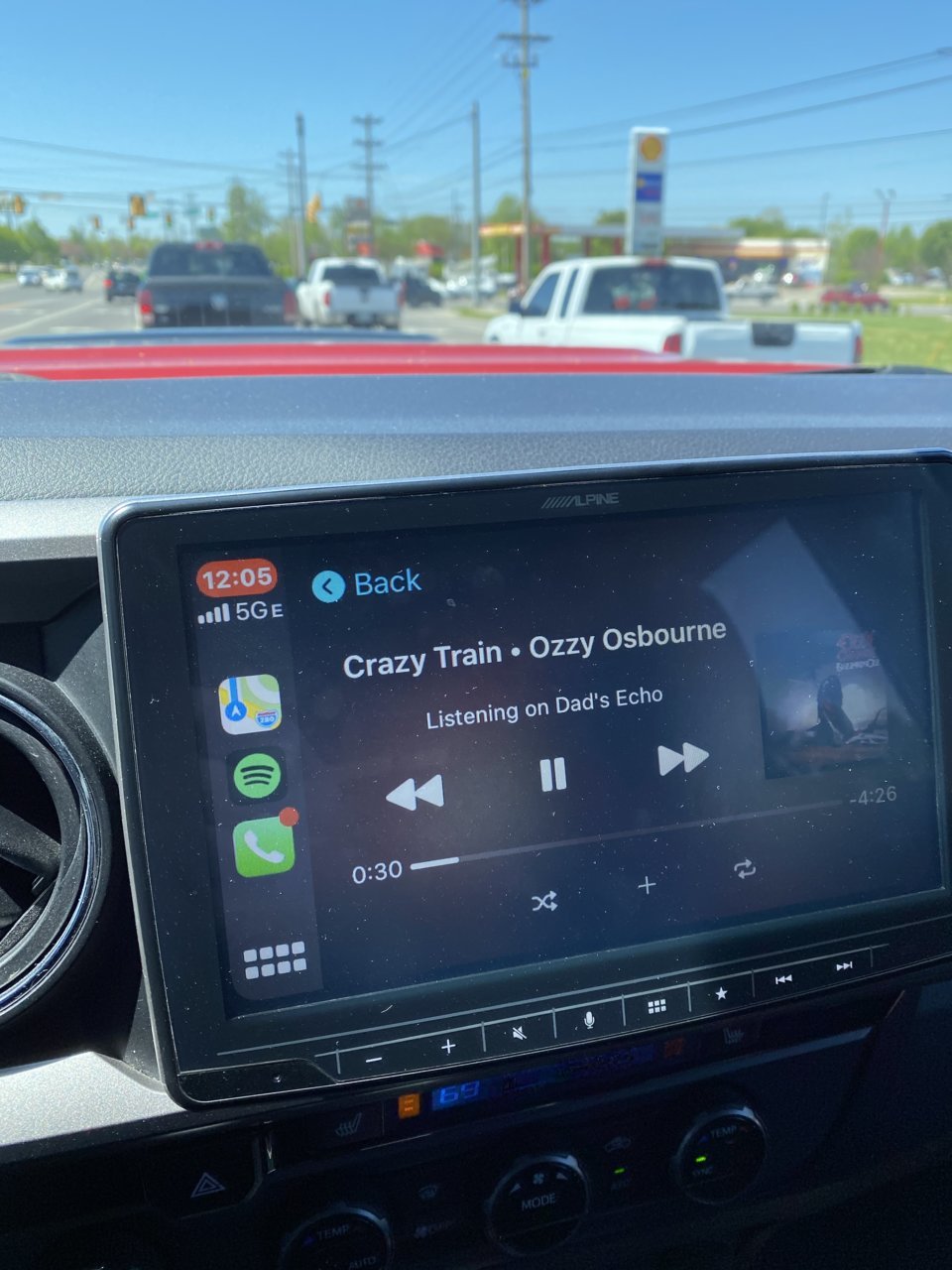

    2017 Barcelona Red Tacoma TRD Pro
    Dropped the Alpine Halo in mine about a year ago and love it. CarPlay, external accessory controls, looks super clean.
