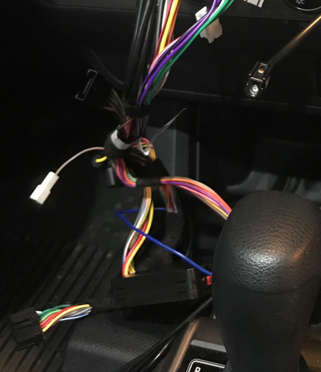

    Beginning reconnect of Maestro module (lower left)

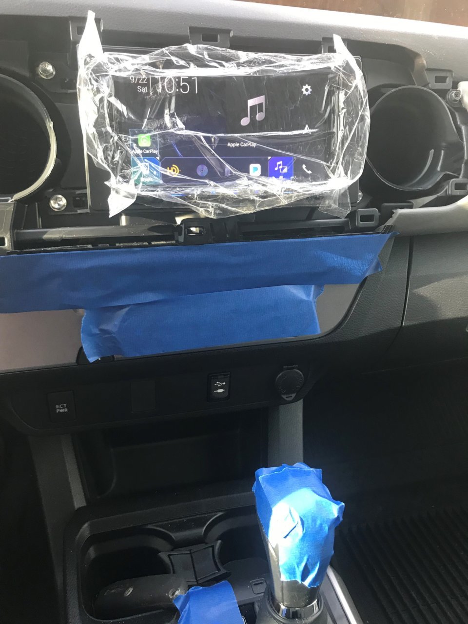

    Blue painter's tape to prevent scratching everything up. Rewiring continues.
    8400 Sitting on the seat to begin testing
    Back in the dash. Plastic covering that glossy capacitive display.

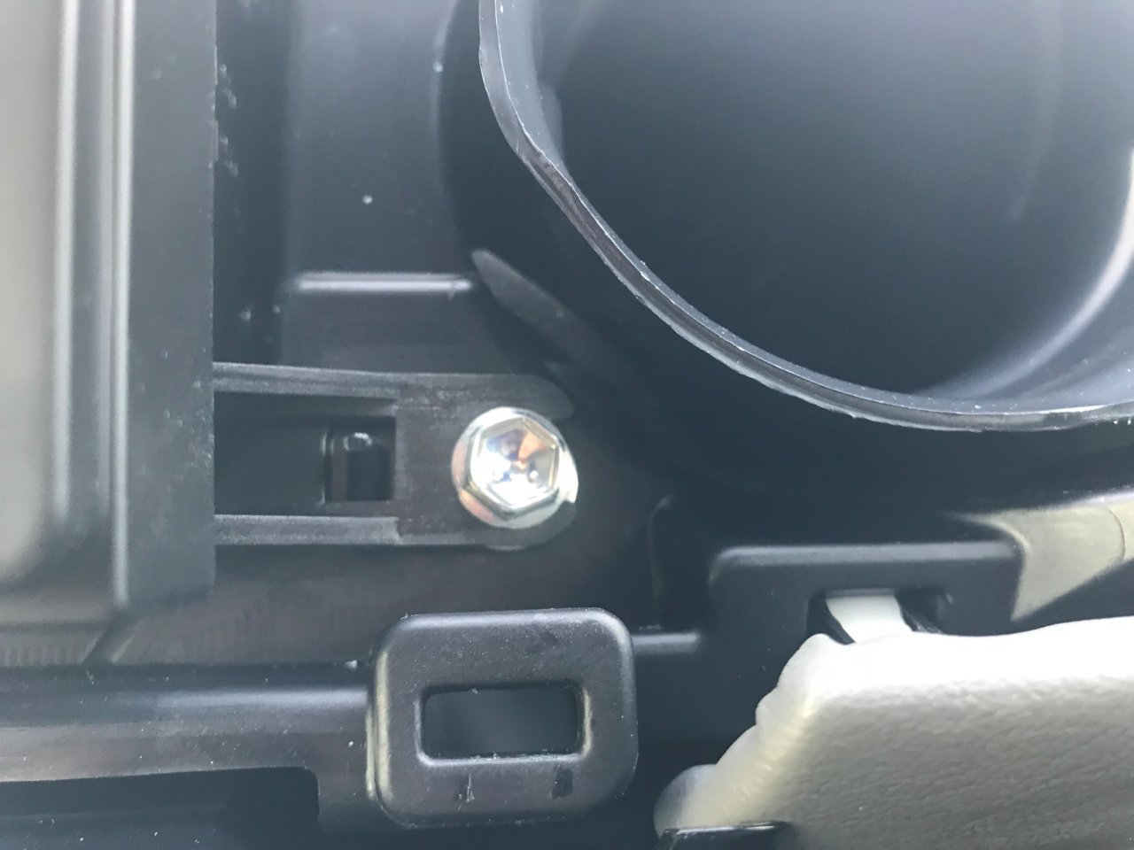

    Hard to see, but there are two washers behind the screw to perfect the alignment of the aftermarket install kit with the OEM bezel. I used a total of four washers....ymmv

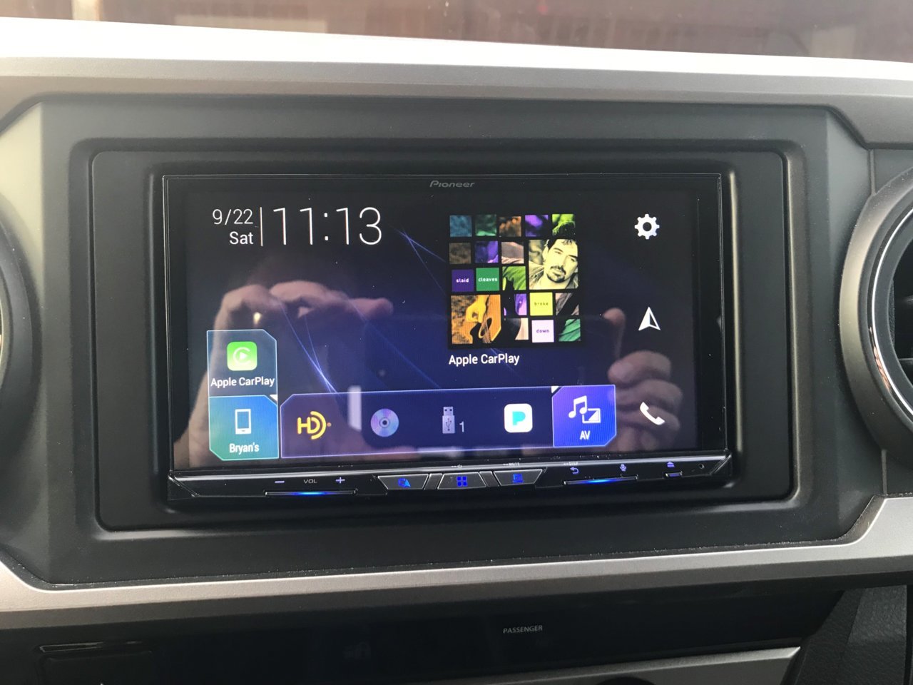

    Carplay...
    Corresponding center display...
