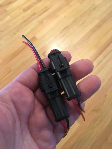

    Re: install- I just removed the little bulb on the far right of the headlamp, delicately stripped an 1/8' of insulation, wrapped and soldered the +/- wires into that harness. Then taped up the solders and harness. Purple wire is +, white/black -.
    I also installed one of these so the grill can be removed easily.

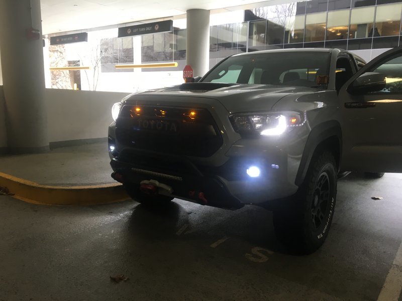

    Bump to add a pic of my tacomapros kit finally installed with BAMF recessed grille.
    I like it a lot. The LEDs are perfect. Nice warm orange color, fairly bright.
    My only gripe is the positioning of them, but that doesn't have anything to do with the kit itself. The middle light is set right between two openings in the grille, which breaks up the output a little. I dunno, I might be the only one that ever notices it.
    I think I might eventually mount them in front of the grille instead of behind, but that would require me to snip and recrimp each of the lights, since they are too big to pass through the grille openings. Thoughts on this?
