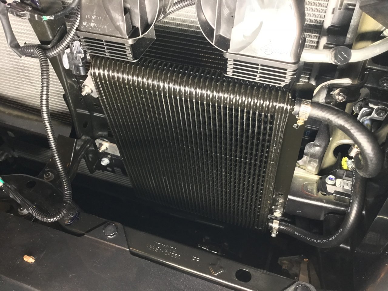

    There are no worries about overcooling with a cooler that has bypass channels as described in the upper paragraph.69F7F55D-601B-4099-928E-CD1C8594F6C3.jpg
    The bypass channels are on the right side of the cooler running from bottom to top. F3563437-3119-4145-8703-06E5BA419423.jpg
