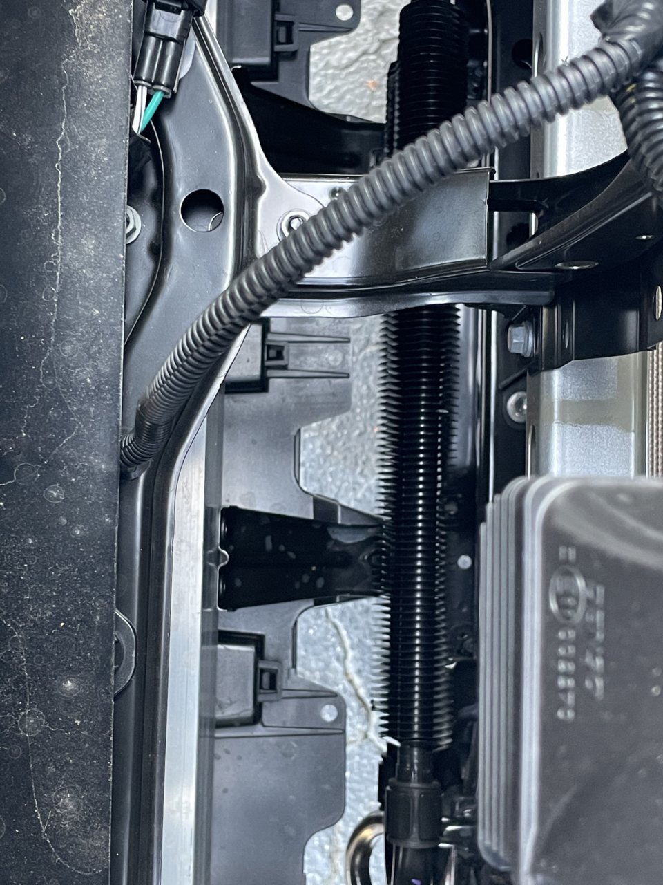

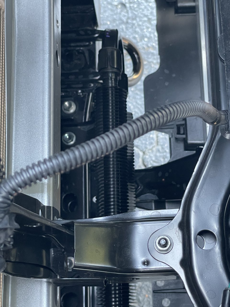

    BC95BE11-C737-4022-9F4D-74883104D868.jpg BC95BE11-C737-4022-9F4D-74883104D868.jpg I have a 2021 off road .. I just opened the hood and at the bottom of the radiator there seems to be a oil cooler or something.. it’s black with fins and has two lines coming in and a single line on the other side .. is this a oil cooler or a trans cooler

    Looks like Power steering cooler to me.
    JJ Diablo likes this.
