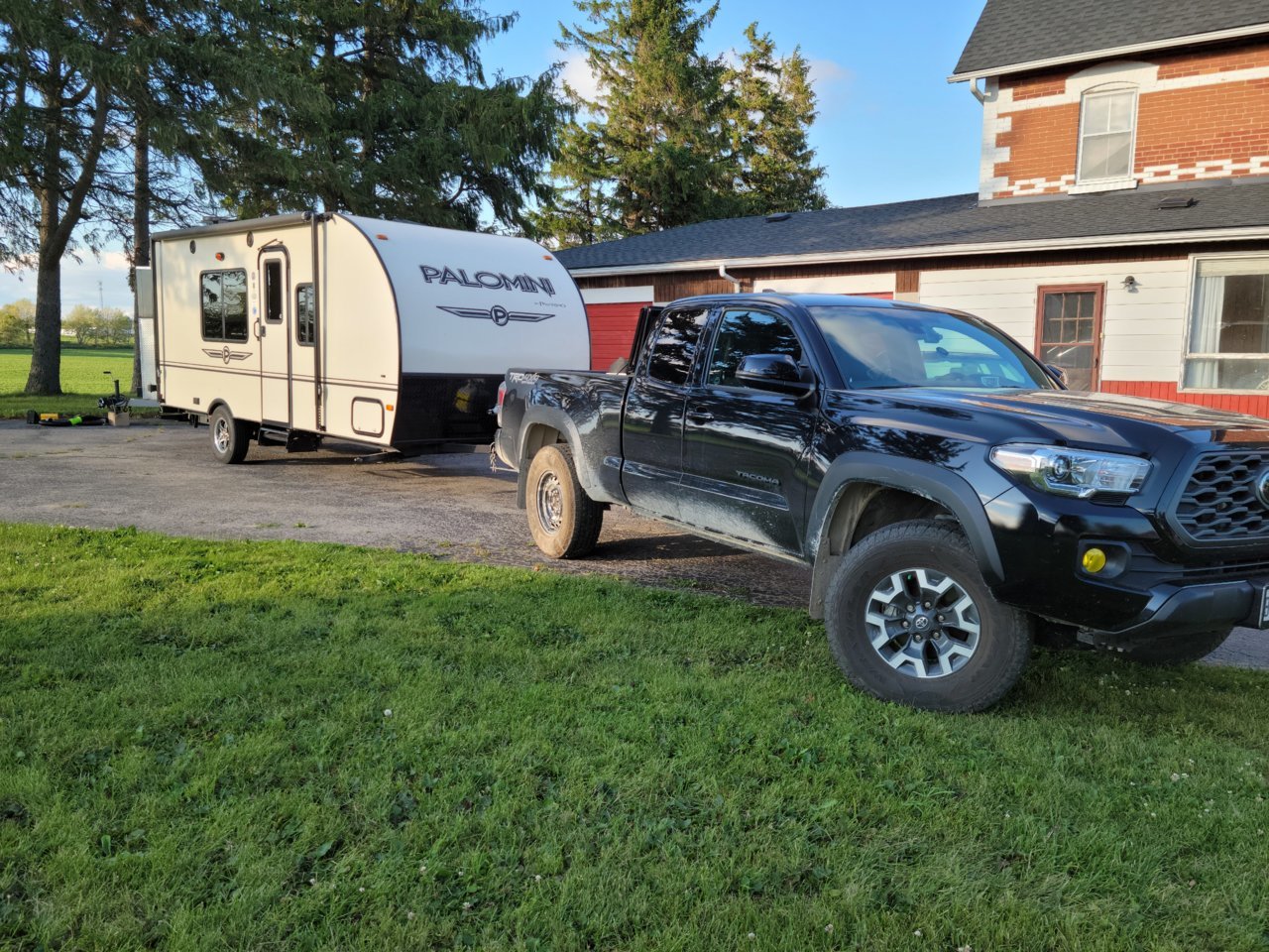

    Figured I'd throw my more experienced 2 cents in here, after I decided against adding an aftermarket one.
    This is what I tow, a 18ft Palamino Palomini. It is 2950 empty, 4000 max load, with water. I more often than not have the truck loaded to payload while towing it, with a dirtbike in the bed. Towing at a rough average of 65mph, over a 600km trip, while data logging, I recorded an average trans temp of 197f. While a tiny bit high, I didn't have any issues with it, so I decided I'd just leave it be, as the truck performs amazingly. The highest I've seen over my 3000km in total towing this trailer so far was 203, and that was WFO, up a hill, in 98f heat.
    An important thing to note is that I'm close to sea level, in Ontario, Canada. I'm in hilly terrain, but rarely climb over 1000 feet of elevation.
    Sorry for the terrible formatting, I'm on mobile.

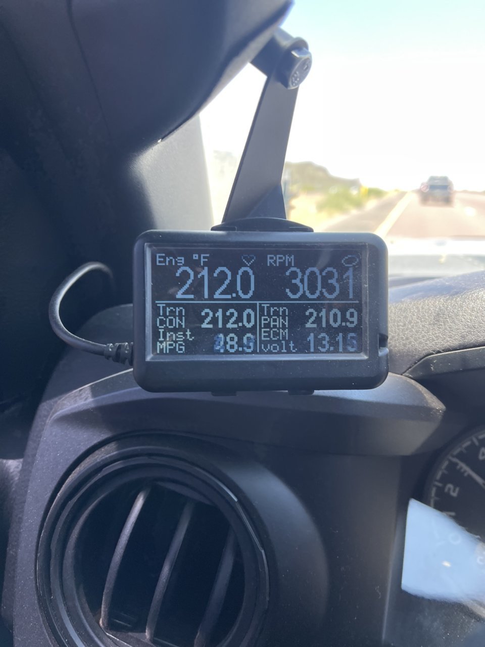

    Blows my mind lol. This is basically empty (5 gal water, camping gear) up a hill.

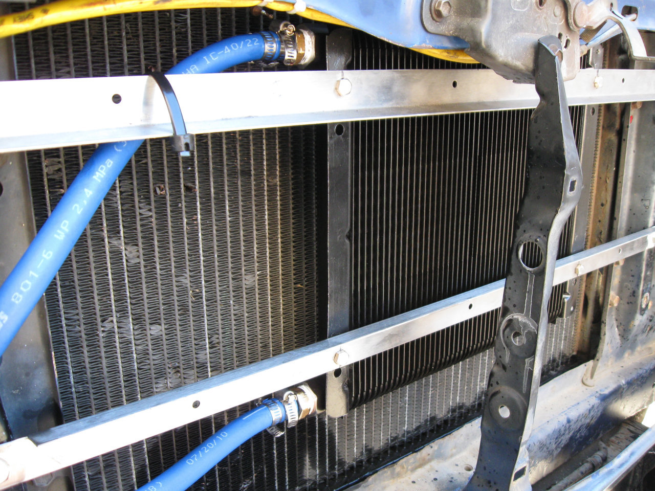

    Maybe too late, but I ran a B&M on my fj62. It was the largest one they made. Cost around $80.

    Jeez! What kind of elevation are you at? I'll try and figure out how to upload the file containing the info I quoted from my phone.

    That was prooooooobably taken at 2500'. But don't quote me. I can run 205 just driving on the freeway here though.
