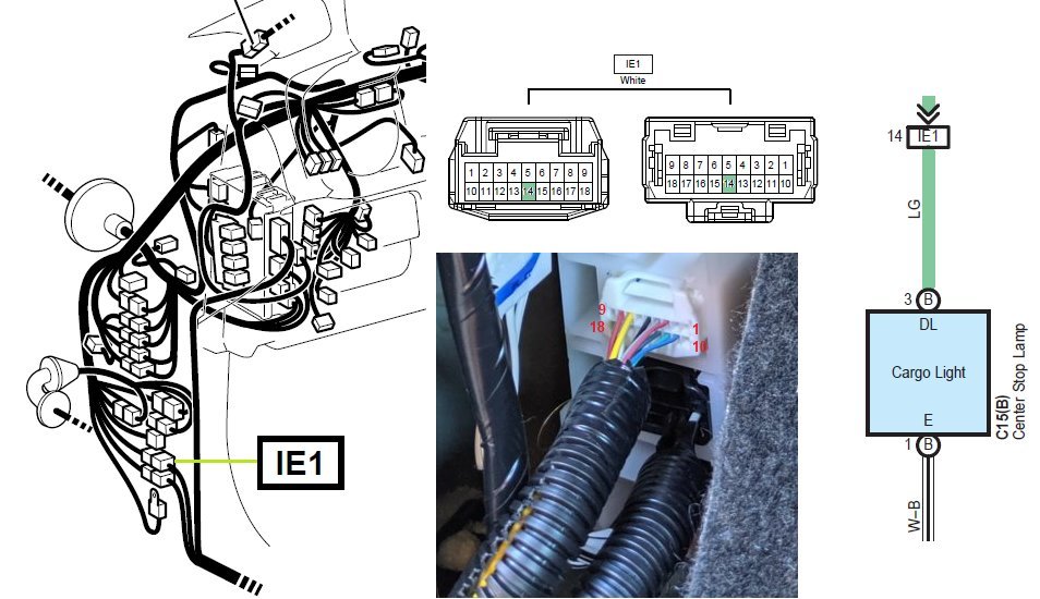

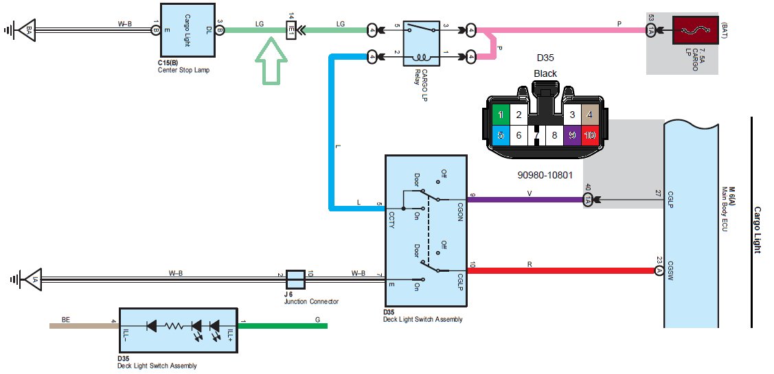

    OP, i’ve done this for my rock/puddle lamps. I ran the new relay under the hood, using the battery posts for power and ground, with a signal wire tucked into the cargo lamp’s relay pins in the dash. Not ideal in-cab wiring, but has held up and works as designed

    Note i have it tied into the load side of the cargo lamps relay, not the smaller control circuit

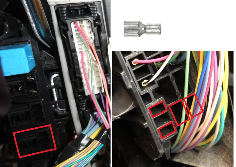

    (Pic has no Cargo or Seat Heater relay)
    You could place a Denso Relay in the bottom relay slot for your added lamps. (Using un-insulated crimp connectors) Then place a jumper from the Cargo Lamp pin 2 to the added relay pin 2 also and have the lights managed by the Cargo Lamp Switch. Power for added relay can be had from fuse panel.
