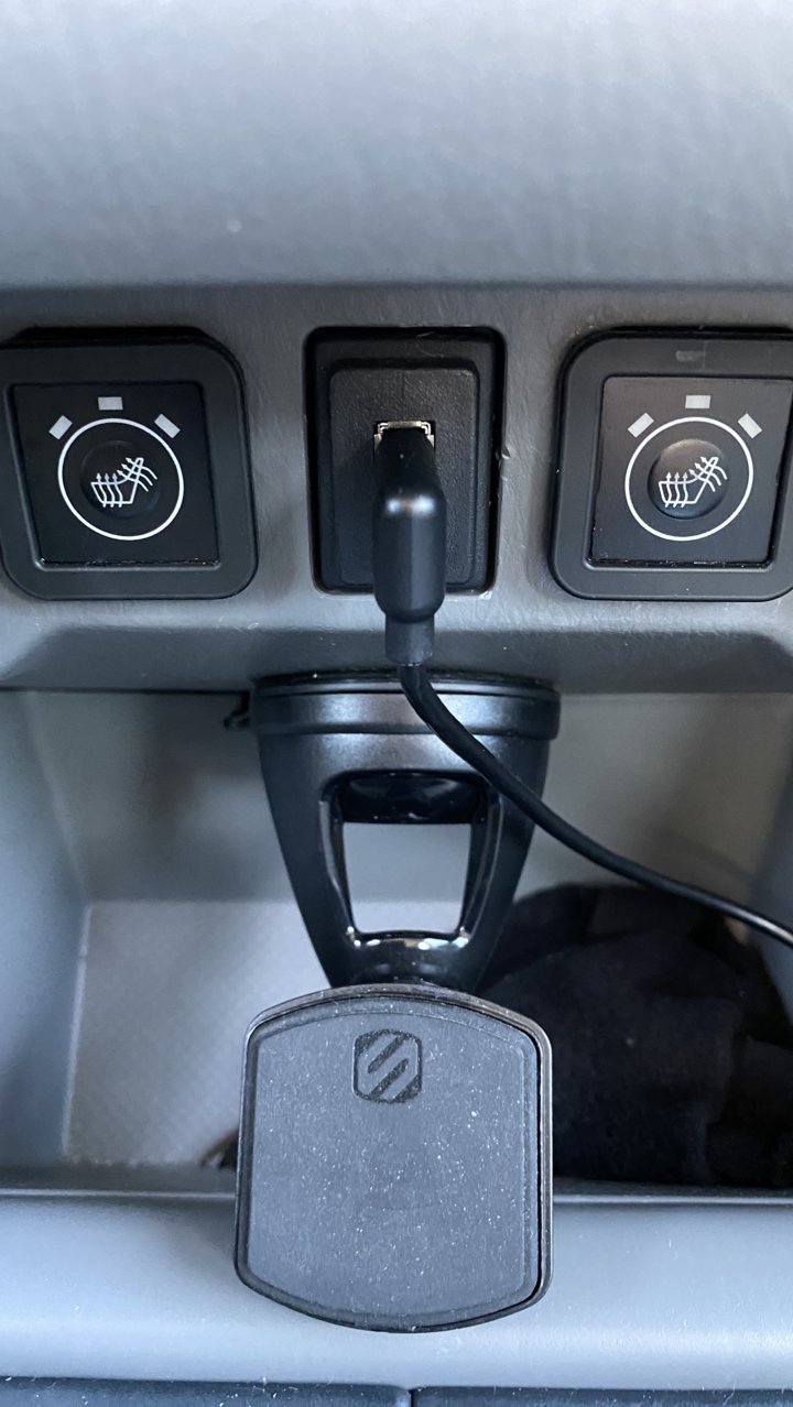

    I got one running to my HU i used one of the blanks in the middle 6383286F-3C48-4C67-A6A6-68D910E57F08.jpg

    I saw some like that but my truck doesn't even have those blanks... that's why I'm going for the cigarette lighter route.

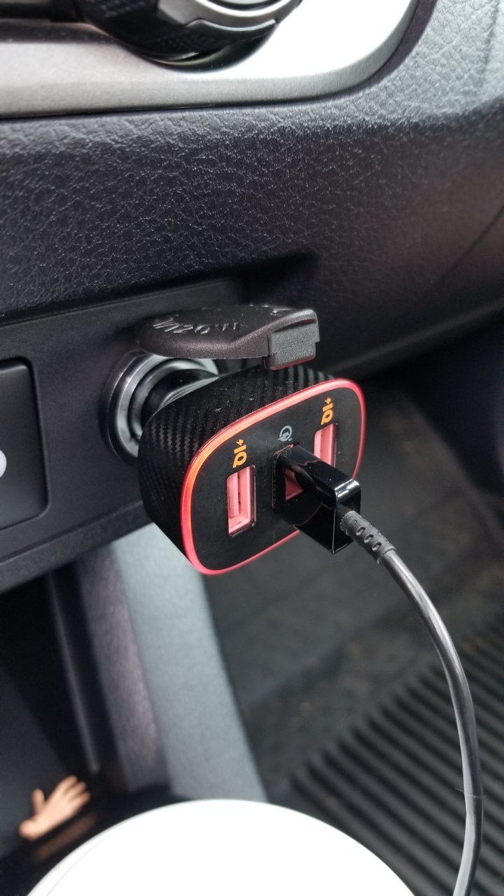

    Here you go:
  16. Oct 14, 2020 at 1:29 PM
    #16
    Fullboogie
    Fullboogie Well-Known Member
    May 8, 2017
    #218539
    1,124
    Dave
    Houston
    2007 Prerunner & 2008 4Runner
    Keep in mind there's a lot that needs to come out before that panel can be removed. It's a bit tedious.
