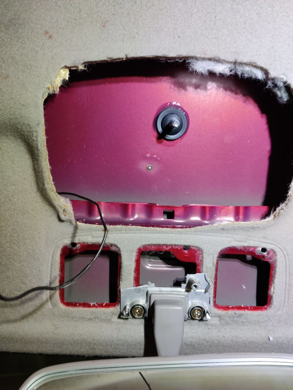

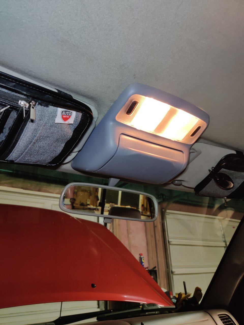

    I just barely finished installing a 2000 4runner overhead console in my 2003 tacoma

    Colors aren't quite the same but I'll forget about that eventually IMG_20210210_145055.jpg

    I had to hack down the mirror bracket for the new map light to fit over it. The Pos wire going to the stock map light was actually able to plug directly into the 4runner lights but I did have to add a ground wire to complete the circuit.
