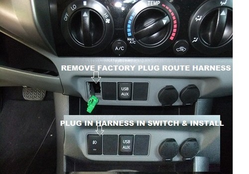

    I was just reading about the switch again and saw this:
    Less than 10 mins!? :rofl:
    Maybe if you didn't have to take apart the entire dash to access the center switches in a Taco.

    ya don't. use feeler gauge or spudger and BAM switches pop out forward
    only if you need to mess with wiring beyond the slack, is it hard to do

    If he is adding a switch he would need to route the wiring and wiring harness back there. Unless someone has a crafty way of sneaking the wires into that area then there will be some level of dis-assembly needed.

    Once you pull the center console, it's easy to feed wires to that location.
    You don't need to pull the dash panel.
