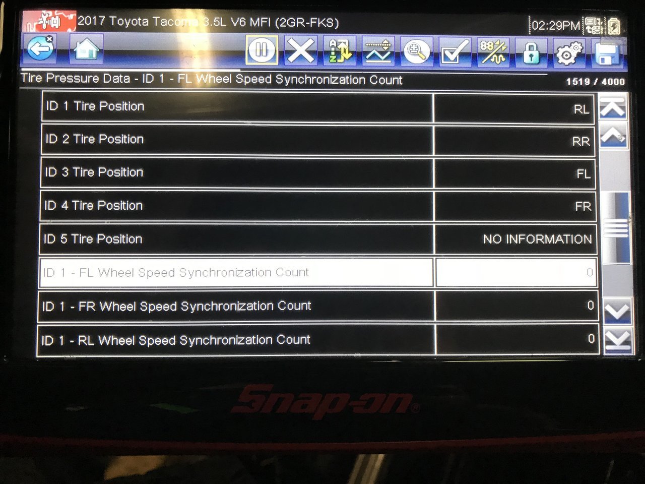

    Efffff’ing lazy bazzztards at the stealership. I’m not usually a peckerhead about dealerships but this one kinda chaps my arse.
    Anyone notice something here??
    So this is the SnapOn tool from a local, privately owned, tire shop with a great reputation. They were incredibly cool today in helping me grab the corresponding code for each wheel location. Spent 30+ minutes with me and didn’t charge me a dime (so I handed the young tech with the SnapOn a $20 bill for his time).
    As you can see, the truck will accept a 5th with the right tool. After consulting with the guys I’m actually not going to register the 5th since the spare won’t always be in the bed, rather I’ll just remove the correct sensor with TechStream and program in the 5th sensor in the 4th spot when I do the rotation.
    So in case anyone was curious. Yes it’s possible.
    yub and boynoyce like this.

    Oh I knew it was .I saw the 5th spot myself on techstream at the dealer.
    Problem is the dealer can't confirm whether or not I can rotate that tire in.
    They didn't say I can't code a 5th sensor they just don't know what it will do

    So I guess the mystery is if you register 5 and do a rotation which 4 of the 5 are being displayed on the dash?
    Personally I don’t care, as I just want to run 5 wheel and tire combos in rotation and not throw a bunch of lights.
    Seems so simple yet very few know the answer.
