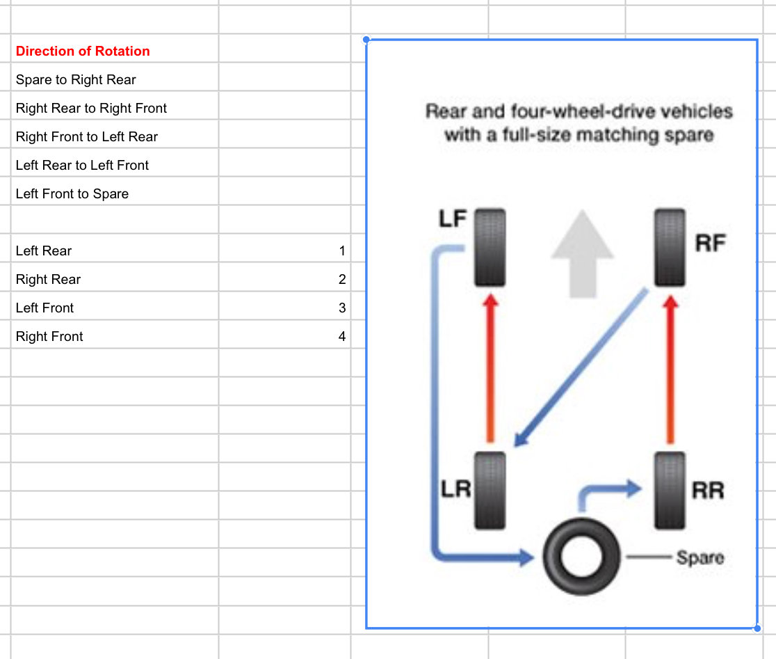

    Just did my 15000 mile rotation this PM. Easy as opening TS. Going to the TPMS utility. Register IDs. Next next. Input 1-4 and close.
    TPMS light flashes for a few seconds and goes away. 60mph+ cruise and all is good.
    Third time now.
  11. Sep 20, 2018 at 5:52 PM
    #71
    TFly

  12. Sep 20, 2018 at 5:56 PM
    #72
    MCDavis
    MCDavis Taco life is over. Full time 4wd for the win.
    Nov 24, 2017
    #236768
    664
    RIC, VA
    2017 TRD Sport 4wd (SOLD) - Currently in a 2016 GX460
    You can enter them into each location so the truck won’t have to learn them on its own.
    See positions 1-4 below.
    I also follow this rotation pattern
