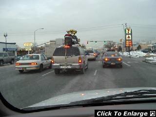

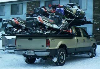

    You can drop the tailgate entirely when loading/unloading. Since the skid is the lighest part & its wider say than a motorcycle tire being more than likely a 15" track the weight will be distributed better but to load & unload I would drop the tailgate unless your coming off a snowbank. Loading the opposite way I would worry about the windshield & the weight of the engine too far back. Your front would be pointing at the sky.
    Heres a couple of pics I had on my laptop for some ideas :D

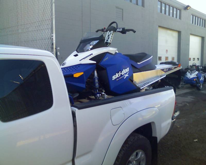

    I don't know how the post TSB tailgates hold up, but with the older ones, your track will bend out your tailgate a lot. Especially on long, bumpy trips. I bent mine in and out so many times the metal cracked at the top of the tailgate. My 02 Summit 800 skis fit perfectly between the wheel wells, and I find just a sheet of 3/4 inch plywood cut the length of the box+tailgate keeps things from bending (you can spend more time and fit it in front and behind wheel wells to keep it there longer). My girlfriend's 08 FX Nytro doesn't fit between the wells so for a ghetto fix, I joined 2 pallets together with a bit of space between them to extend it to the end of the gate, but it's not ideal. If you don't strap them together, you easily spit the back pallet out the back when loading. I've seen some sweet, home-made, false floors built to the top of the wheel wells, with slide out ramps underneath. I usually just use a snowbank to load or lift it on with a buddy. Don't load your sled backwards, the engine is the heavy part and it will be too far back. Plus, it looks really stupid.

    Great now I need a roof rack....:D Man, those are some crazy bastards.

    The false floors were made of wood using 3/4 plywood and 2x8's I think. They look solid and if you fit them in front of the wheel wells they won't be going anywhere. I didn't make one yet due to the mushy suspension with just the sled in the back. My idea also involved some pull out ramps with a raised outside edge to keep the skis heading into the box and some hooks at the front of the ramps to hook onto a metal coping at the back

    new ride, sitting on pallets since the skis are too wide and the pre-TSB tailgate is pretty much cracked in half. TSB suspension and tailgate tomorrow
