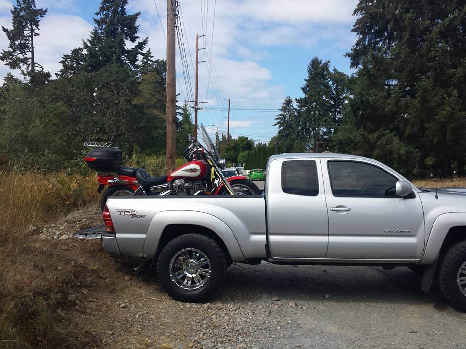

    Here I used a dirt bank to load up the bike but I do have a ramp like this one to load it up with, works pretty well.
    Oh yah, I use just regular straps to tied it down to the D-rings located on on each front corner of the bed.
