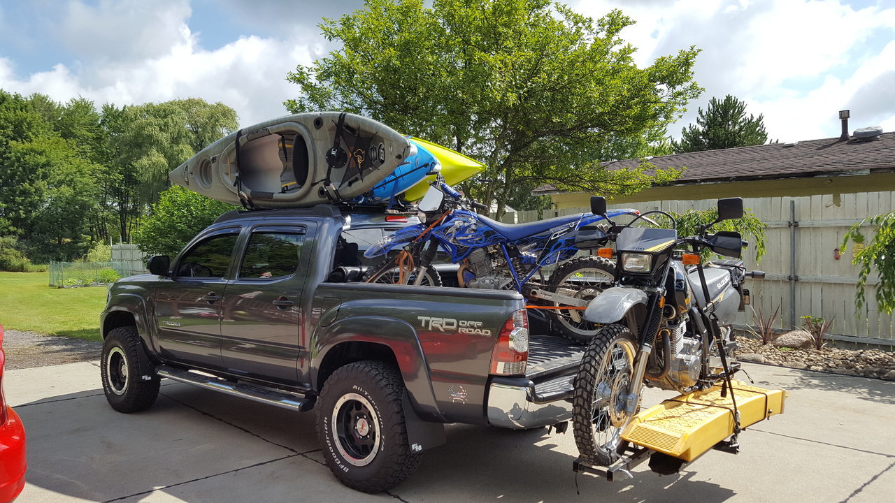

    Look on Craigslist or buy a motorcycle carrier that goes in your hitch.20170708_104928.jpg
