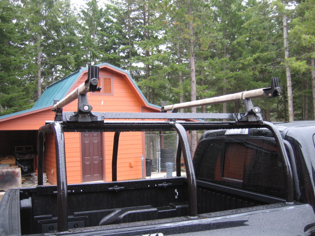

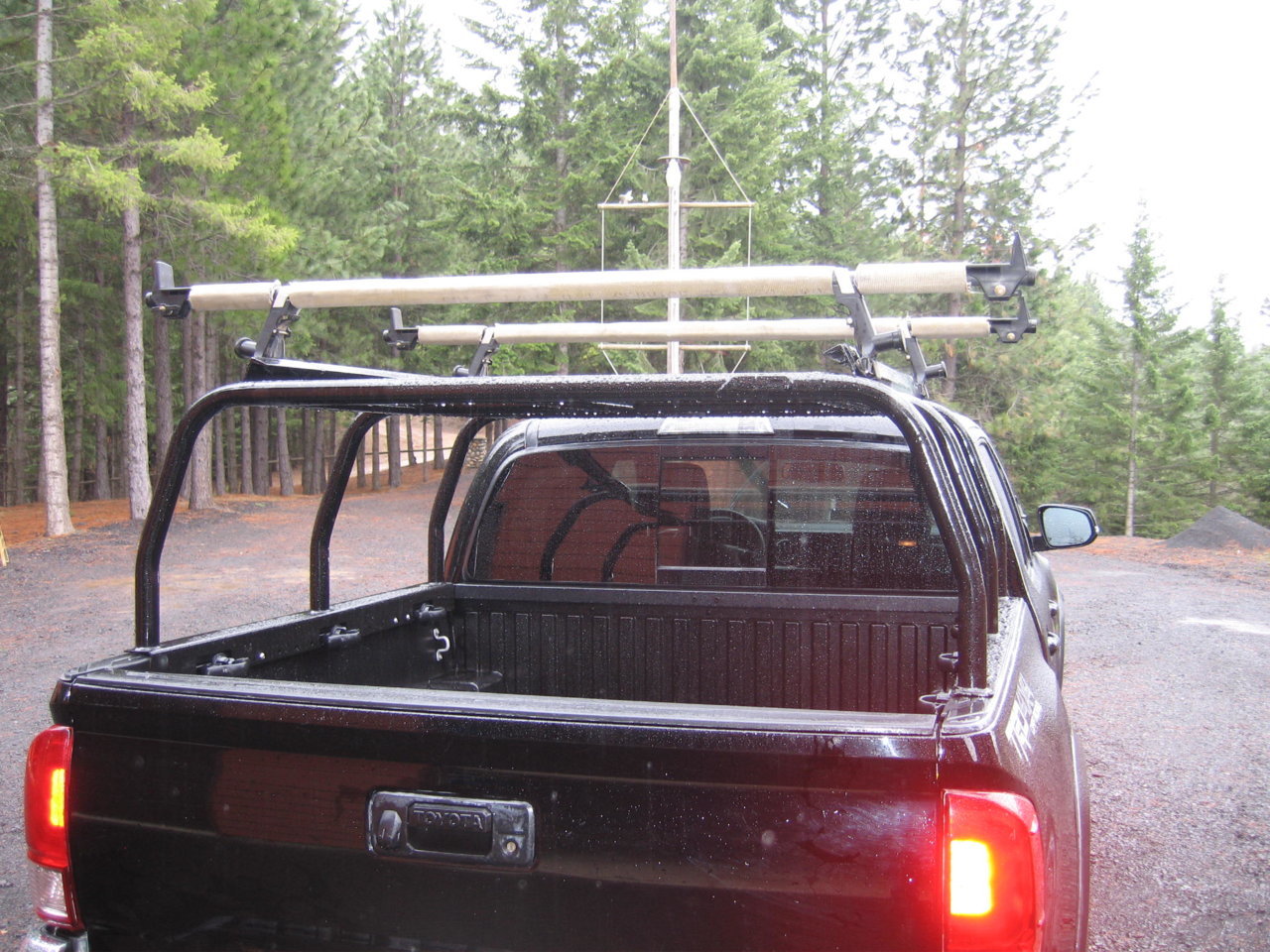

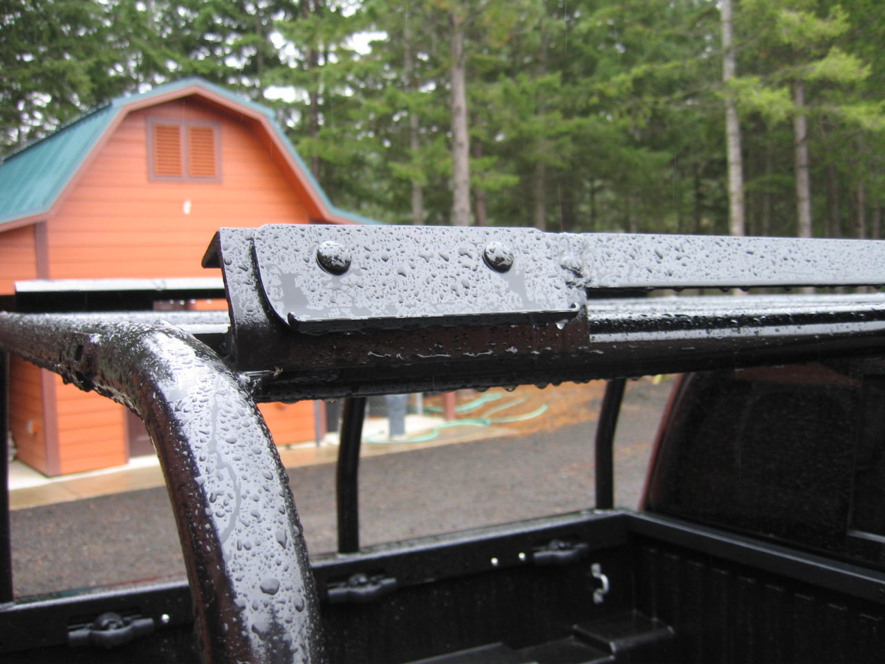

    I have a cab high bed rack, AllPro Offroad. Attached to the rack are plates that simulate car roof gutters. A Yakima rack is then attached to those plates. The Yakima rack is wide enough to carry two paddleboards side by side. I only use the Yakima rack when carrying long items that extend over the cab.
    For those looking for a paint that applies easily and from my experience holds up really well consider John Deere gloss black paint available at the John Deere dealer.
    AllPro Offroad Bed Rack.jpg Bed Rack Gutter Clips.jpg Yakima Rack on Bed Rack 1.jpg Yakima Rack on Bed Rack 2.jpg
