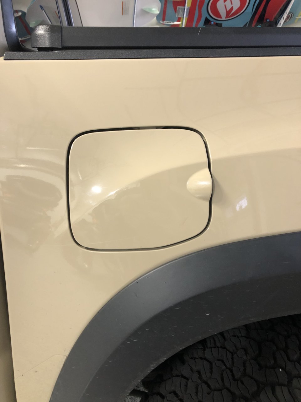

    My 2019 TRD Off-Road came with a misaligned fuel door.
    It is not something too obvious, unless I look at it through the side mirror.
    Last night I was checking out the mechanism to see if I could straighten it myself. Now that I read how flimsy it is known to be, perhaps I should bring it up with the dealer next time I am in for service.

    Lmao I had this problem 3 months ago, didn’t realize it wasn’t just me!
    Bent it back into shape without dealership, but referenced a co workers Tacoma to see what was bent and how to get it back straight like from factory.

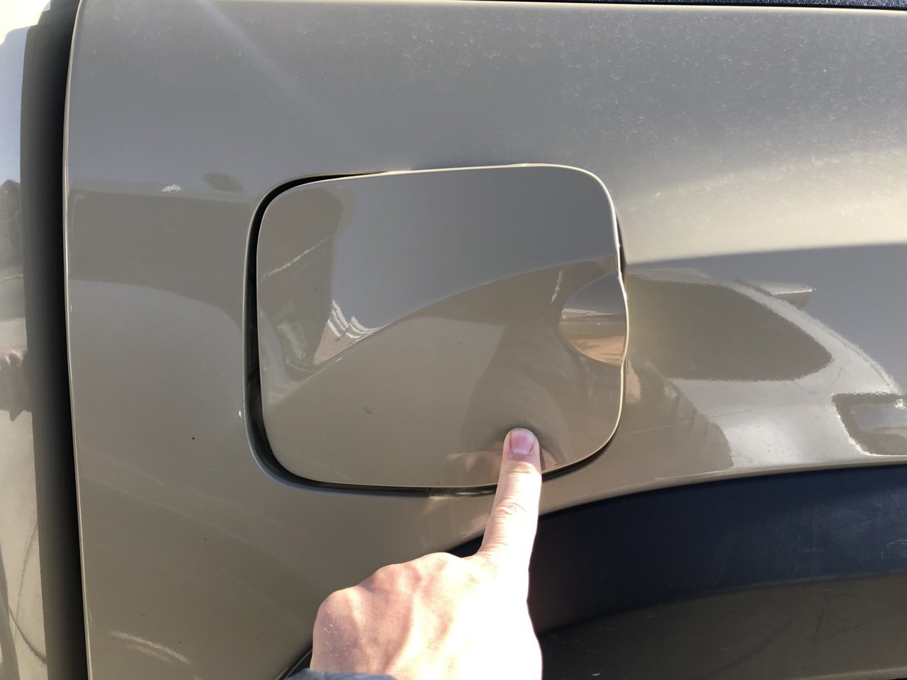

    Anyone have a pic of what the hinge is supposed to look like? 2016 with only 60k mikes. My door was not hard to open at all, stopped for gas, opened it up, went to shut it and it’s super misaligned. So annoying.

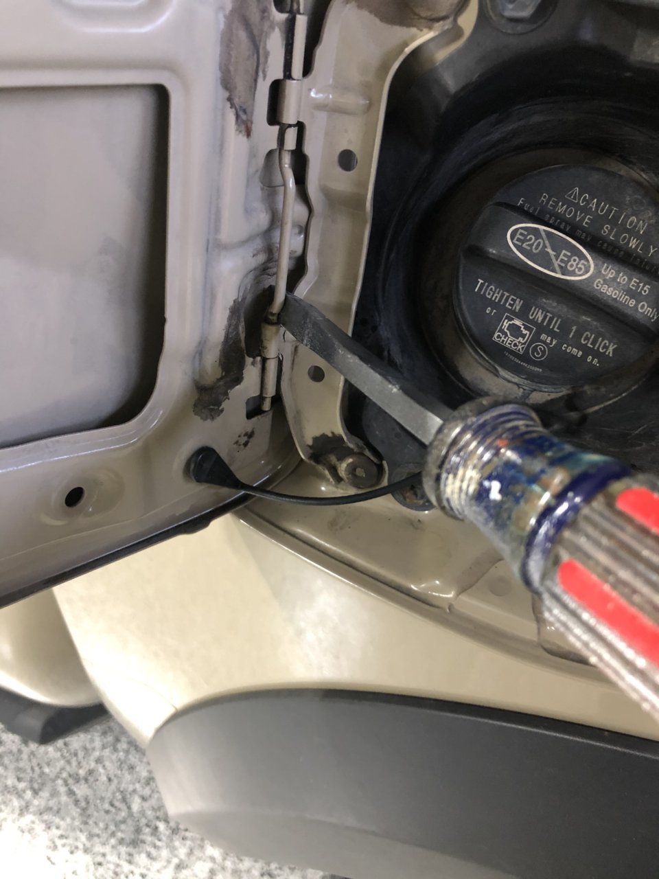

    I figured it out. Lubed up the hinge with WD40 and then realized the bottom hinge had bent rearward towards the back of the truck from when I went to close it. Put a screwdriver right above the bottom hinge and pried forward toward the front of the truck. This straightened the hinge and brought it all back into alignment.

    Keep an eye on this, and keep ahead of it! Mine went wonky some time in the last six months (only had my '16 since last September), and I've been convincing it to close. I just tried the bend-the-hinge thing, and it turned into break-the-hinge. It's straight now, but it's only held in place by the upper hinge and the clip. Time to break out the Gorilla tape (on the hinge, not the face; we're not savages!).

    Looks like that hinge pin can spin freely and face toward the back. I'm just wondering how they end up getting bent

    I think the point is that, on some, eventually, it doesn't spin freely. Consider if the pin gets stuck in both halves of the lower hinge: when you close the door, that big lever arm just folds the weak metal of the body-side hinge.
