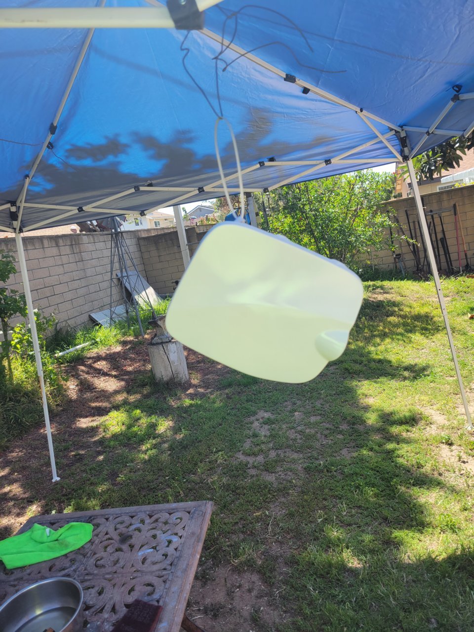

    Yep happened to me 2016 supper white bought a new fuel door from saddle back toyota a can of dupl color and clear coat and painted it my self turnd out pretty good if I had it to do again the last color coat would do a little heavier to have a smoother finish. But here is what it looks like 20220409_131557.jpg 20220411_143827.jpg 20220411_143820.jpg
    zoo truck and Canadian Caber like this.
