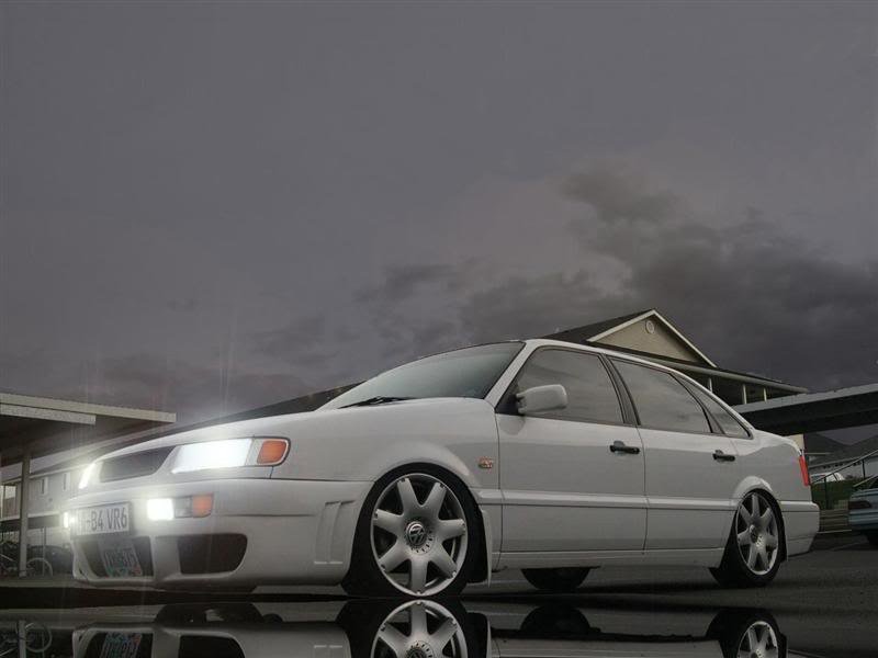

    Agreed... you can do it with a relay but i would not reccomend it.
    if you had sepperate bulb for both lows and highs then yes very cool..
    I did it on my Old Passat Here is a picture...
    Man that car was fun....
