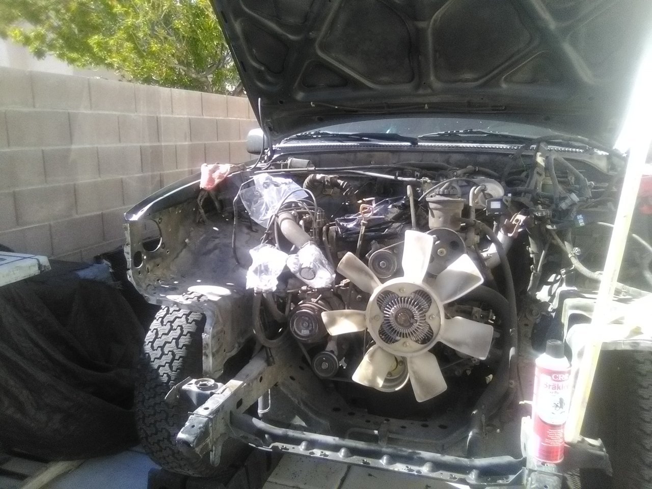

    Thank You!!! I could swear they use to blink. LOL. I think I'm delirious from from doing nothing but work on it for days. Here's where I started after removed the bashed up metal.
