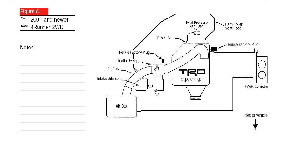

    I'm assuming since you have an 04 like me you have a Drive by Wire Throttle body. If so, this is you're vacuum diagram (nevermind it says 4runner):

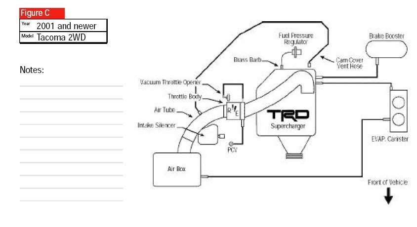

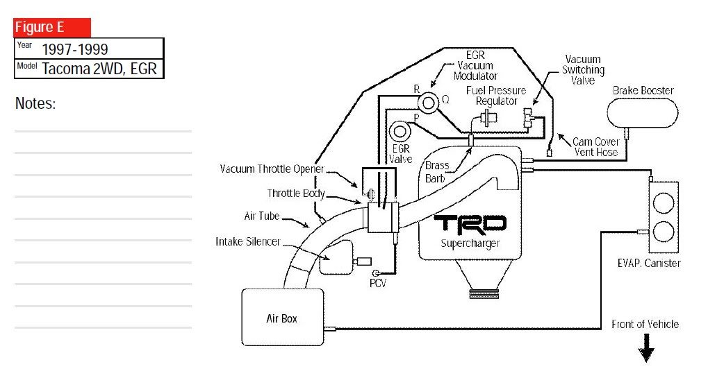

    If you still have a vacuum thottle body, its one of these diagrams:
    The boost/vacuum line that runs to the AIC is supposed to T off the line that runs to the fuel pressure regulator.
    Absolutly, 89 octane will make you ping.
    One other note. The vacuum/boost line that runs to the AIC will make a ticking sound. At first listen it might sound like a ping. Depending on where you mounted the AIC, you might here a pulsating sound coming from it at low RPM ranges. What you are hearing is the supercharger impeller pulsating and that sound travels through the vacuum line. Even with the restrictor T that URD sends, I still hear the sound at low RPM under moderate boost. Listen close, it's not a ping. It's a perfectly synchonous sound and not sporadic like the old pinging sound.

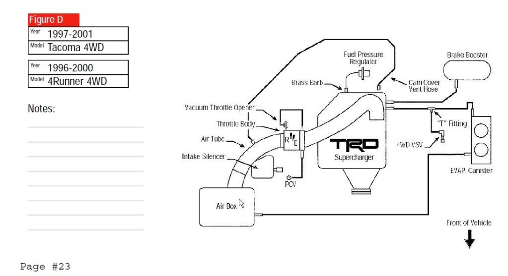

    One more diagram for good measure
