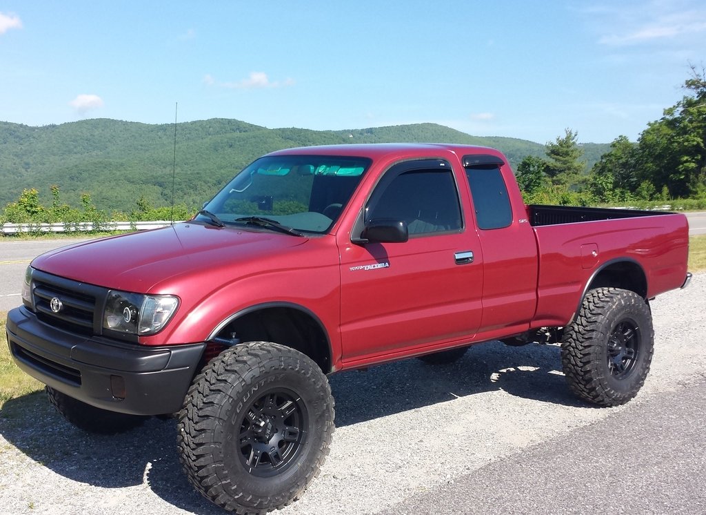

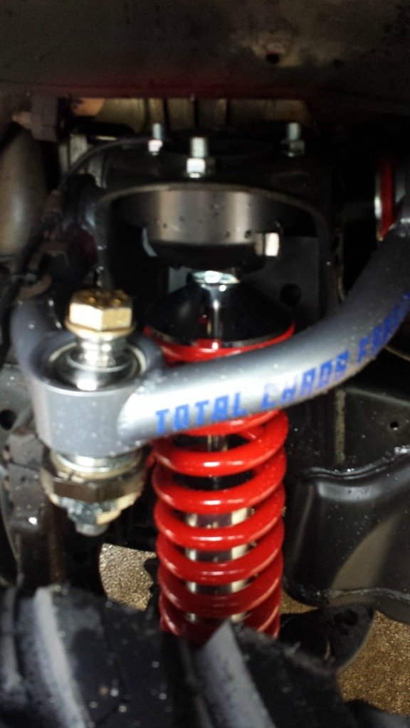

    As she sits as of 5-2015:
    fd36aaf9-db33-483b-85e1-e648de4eed6e_zps_ccc67c37e12438b7fce190af2cdfea695370f6c0.jpg
    98' Taco SR5, 3.4L, 5 speed, 4x4, 177,000 miles(Bought with 146,000).
    Mods:
    -Toytec Boss Suspension System(with Diff. drop)
    -Total Chaos UCA's
    -Complete OME Dakar leaf springs

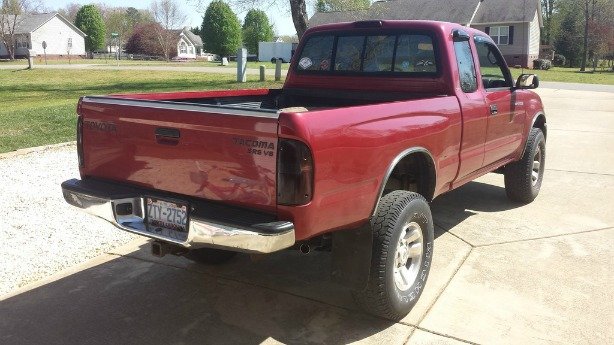

    Her before shot...I really didn't like it enough before to take pictures. lol. Of course mine was already older, not a TRD, and had some factory running boards.

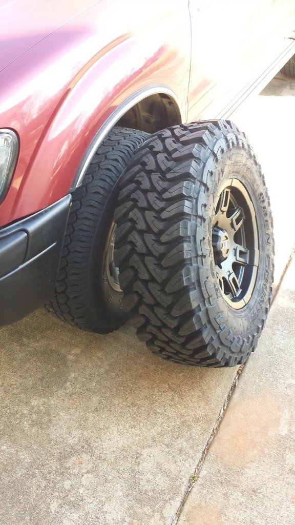

    New wheels/tires next to old wheels/tires/suspension:
    20150401_173508_zpszqzrxx011_zpsbi9hyuuo_1b88934993af658fb5ce2819694372ebaf0b60a8.jpg

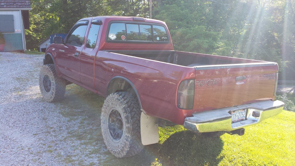

    Taco with just the Dakar kit on rear, with old wheels(15's) and Tires(31's):
    20150404_152417_zpsqlmgssr91_zpsmew7sui6_696db4f9fec09aeb562fd54299626e33605be896.jpg

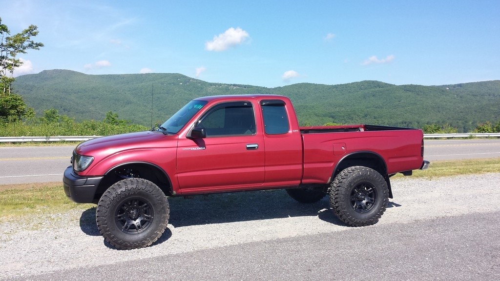

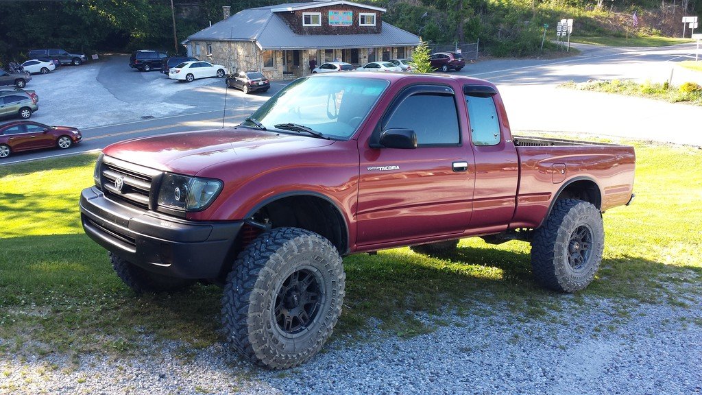

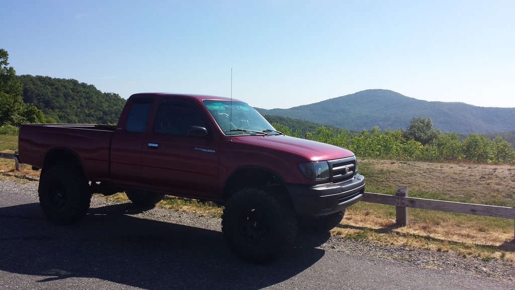

    So here are a couple of pics from this past weekend: 5-22-15 through 5-24-15 at Linville Falls, NC. I surprised my wife with a well needed weekend getaway. I didn't get any good pictures on any trails. Sorry, but I did get a couple at an overlook. Thanks for checking it out.
    Brown Mountain Overlook
    Signs of the kids despite being >100 miles away. lol.
    Right after leaving Table Rock: 7 mile dirt road = dust!
    You can tell I had some tire shine on previously. lol.
