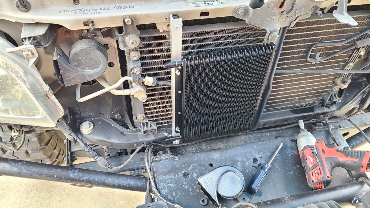

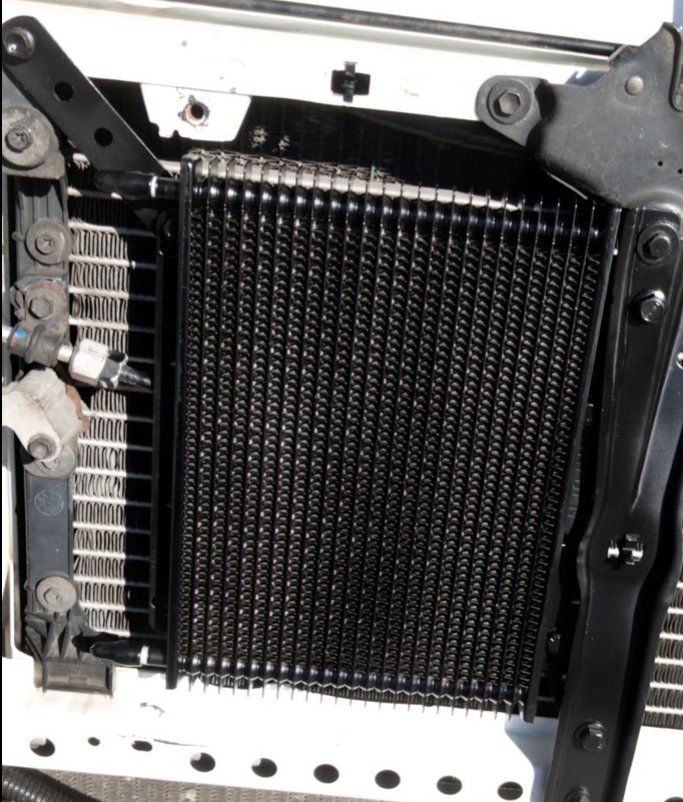

    I just finished up the trans cooler install. Great write up by the OP. I followed every step except for the horn re wire. I just used the same hole on the top of the L bracket. I added the in line filter that Timmy recommended in his 4runner video. I used his video as a go by for the plumbing.

    @zero4 HUGE THANK YOU brother, I followed most of your steps in the Transmission Cooler installation, along with a new Radiator, hoses, thermostat. Tomorrow I'll finish with filling up the radiator, and burping the cooling system, and the last hose connections for the cooler. Purchased some nylon spacers to try for the cooler mounting, we'll see how well they hold up. But it was a brilliant idea, I just don't have a machine shop to make the aluminum ones. This is what I truly enjoy the most about TW. If you have something that needs done, someone else has already done, and usually posts pics and instructions. Too tired to post a pic right now, maybe tomorrow.

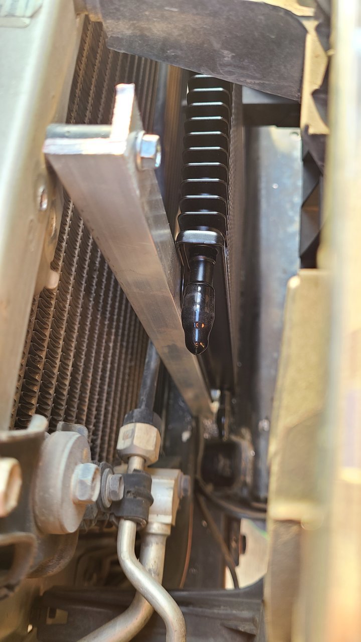

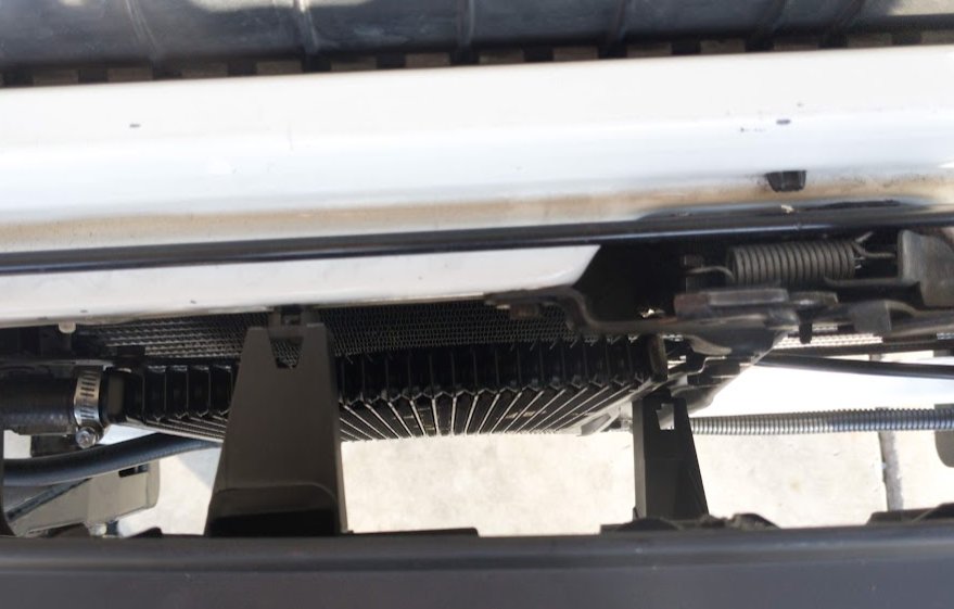

    I noticed that many of you ran spacers, are they necessary? I have mine mounted at a slight angle and now I’m wondering it it’s effecting it’s efficiency

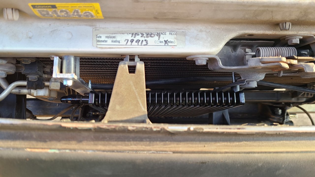

    best mounted to the frame for max cooling. i have the 677 model, centered on bottom frame with 2 tek bolts. then took the 2 supplied metal straps and formed a triangle, tek bolt to the lower frame. cooler is oriented same as OP's.
    look at post #99, except i have inlet/outlet at the 3 o'clock position. less air obstruction on condenser and radiator that way.

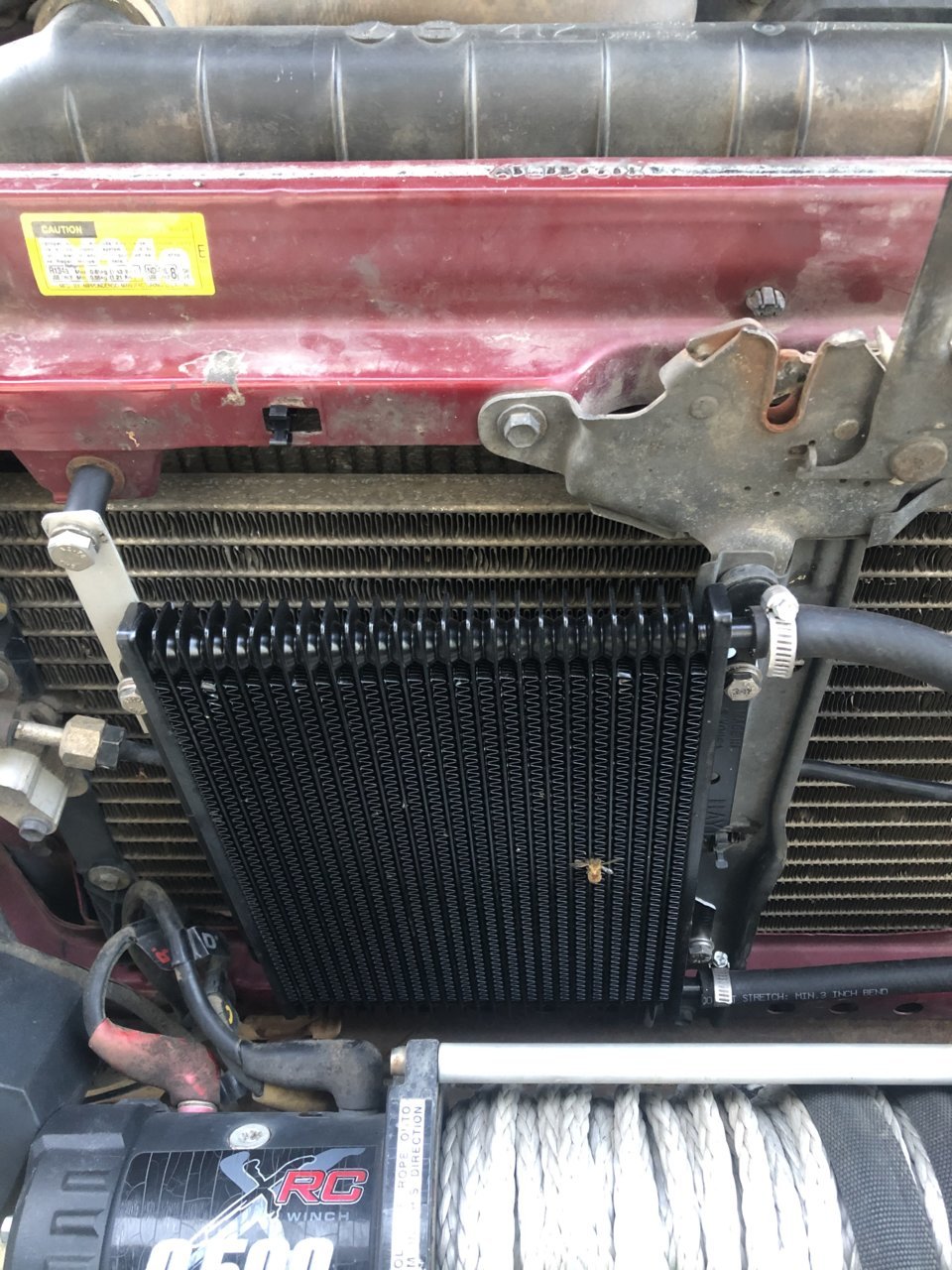

    GOOD

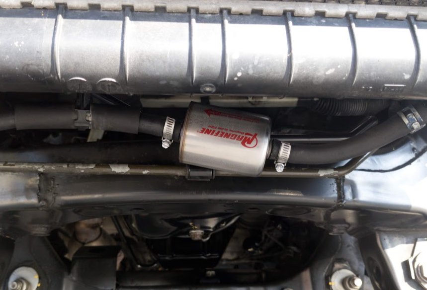

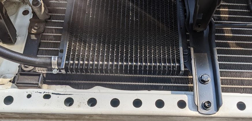

    Don't even want to think about how long it took me to finally get around to doing this... damn cooler sat in a box on the shelf FOREVER.
    Slapped the Magnefine inline filter on the return line before it hits the Hayden. Hose for the return is new but was being lazy so will replace the send hose (from hardline to passenger side inlet), when I swap in the A340F.
