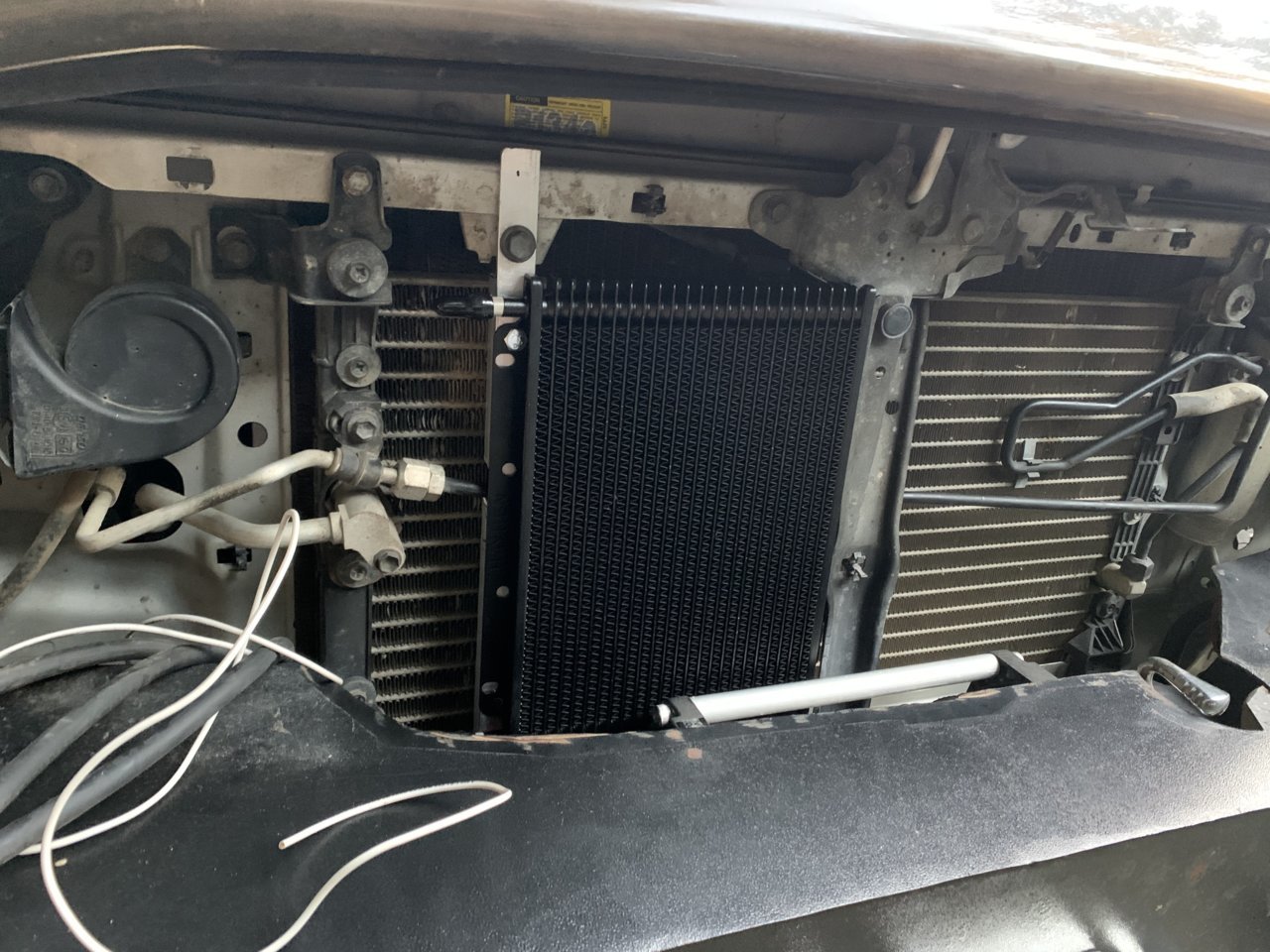

    You mean so both outlests are on top? Yeah, I would think that would be better than what yo have now.
    I just remember the instructions for mine being pretty specific about the orientation.

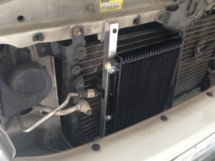

    I’m pretty sure that with a Long (Tru-Cool) LPD cooler it is designed to bypass most of the cooler when the fluid is cold to help it warm up.
    https://www.trucool.com/products
    I live in Colorado and going up passes will run the temps up a bit but usually dropping down a gear will keep them under control. I generally see 70° above ambient temperature around town once it’s up to operating temperature (1/2 hour).
    My outlets point up. I duplicated the old TRD mounting system with rubber mounts. Gates hoses from O’Reilly’s. Spring clips instead of hose clamps.

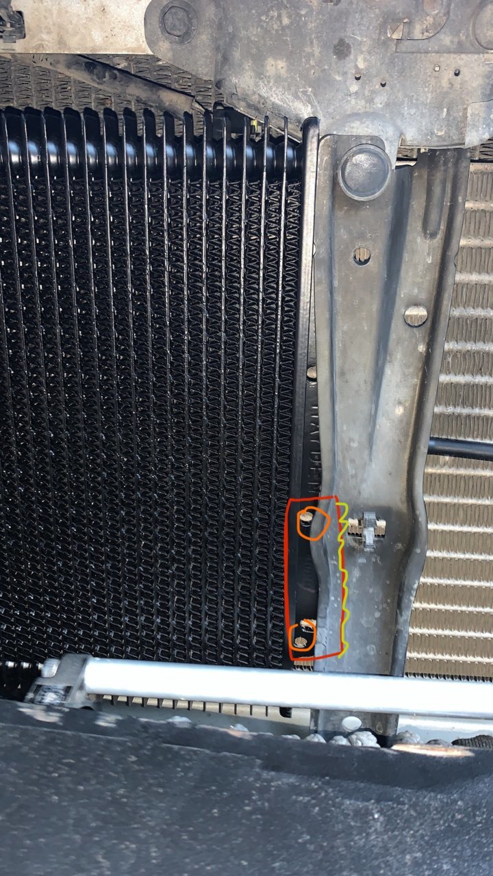

    Nice pic. I was wondering how OP cleared that annoying ass hardline but didn’t seem like he had a notch. I’m just about to notch mine to clear.
  19. Nov 28, 2020 at 2:34 PM
    #179
    frenchee
    frenchee Favorite Member
    Aug 4, 2015
    #161024
    2,131
    Oceanside CA Area
    2003 Tacoma TRD Double Cab 4x4
    Converted to 4WD DD VW MK6 TDI
    Well, been trying different methods/locations. For now, that hardline can easily be bent so it’s been seeing some massaging.

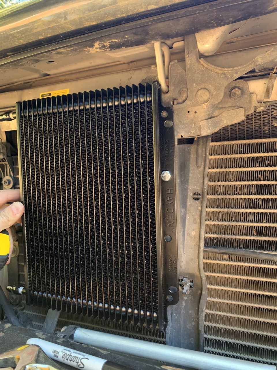

    I have a few more constraints , since I have a winch.
    I started out with spacer method and wasn’t a huge fan of having to come up with spacers , and I couldn’t lower the cooler since it would hit winch bar.
    Tried bunch of different positions and will be going with this here below. I bent the horn tab , so I can use that as a mounting point. It brings in the cooler closer to radiator. Had to massage the hard AC line. This allowed me to lower the cooler and not deal with spacers. I do now have to weld a tab though from the backside. That will be tricky cus I’m not taking out the support to weld a tab. Pictured is how it will be. Weld is the yellow green (on the back of support ) and orange will be nuts on the back of tab. The cooler tab is flush to backside of support.
    Although I barely have any tools here , we just got a welder so thought I’d open up the possibilities.
