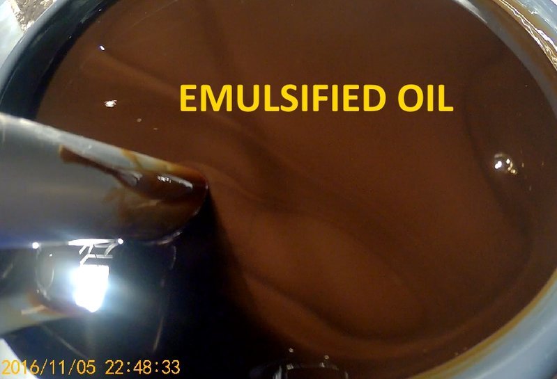

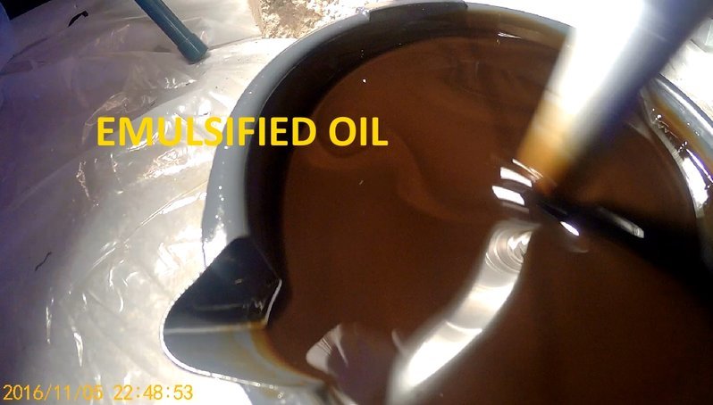

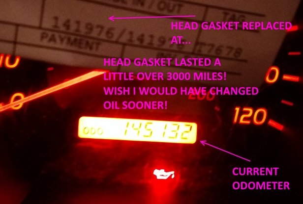

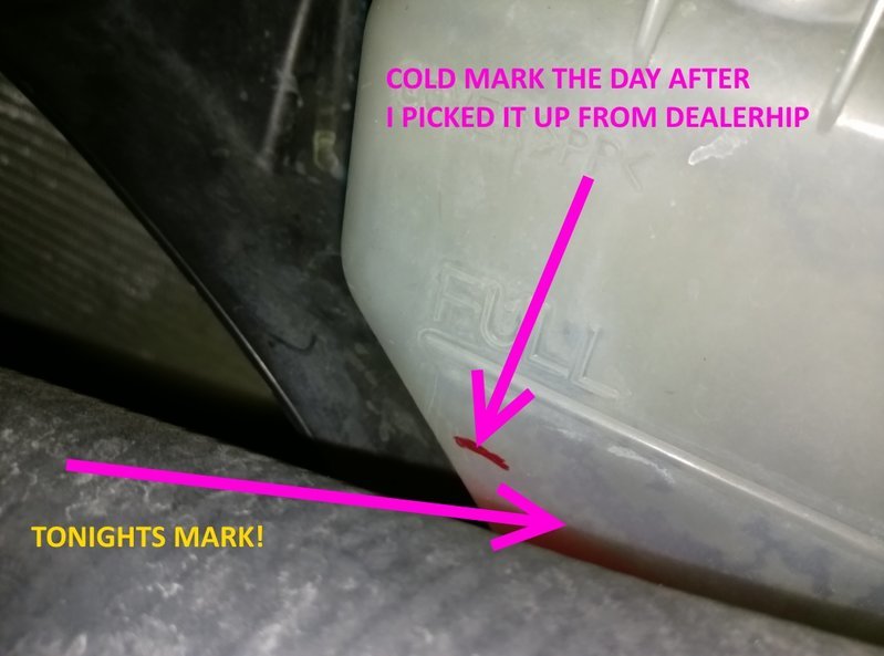

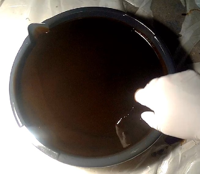

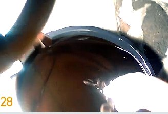

    HERE IS WHAT A BLOWN HEAD GASKET OR FAILED DEALERSHIP REPLACEMENT LOOKS LIKE! ALSO WHAT HAS JUST CREATED THE MOST PISSED OFF PERSON IN THE WORLD!
    Northshore Toyota in Covington Louisiana replaced my head gaskets for the minimal fee of $3,450.04 about 3100 miles ago! GUESS WHAT!

    You will not see coolant in the oil when the factory head gasket fails. Since the day I saw mine unloaded off the truck at the dealership, I changed oil ever 3,000-3,500 miles! Mobil1 synthetic! I use Bosch Premium filters. NEVER ONCE saw water in the oil until now! BTW, I SPECIFICALLY TOLD THE TECH TO USE MOBIL1 0W30 AND BOSCH FILTER WHEN I BROUGHT IT IN TO HAVE HEAD GASKET CHANGED! You can see from pics they did neither!
    My original symptoms were disappearing coolant, swishing water sound from under the dash sometimes when I started it, water from tail pipe, coolant backing up into overflow, then bubbles in overflow, then coolant being totally pushed out and overheated. Literally, the second I saw the temp needle start rising, I killed the engine, put in neutral and coasted within about 100 yards of a Chevron station and pushed it the rest of the way...
    BTW, we have like 90% humidity here, until first head gasket started to fail... ZERO water from tail pipe! After replacement... ZERO water from tail pipe until now! IF YOU GUYS ARE STILL UNDER WARRANTY AND HAVE WATER FROM TAIL PIPE OR OTHER SYMPTOMS DEMAND HEAD GASKET BE CHANGED!!!!!!!!!!!!!!!!!!!!!!!!!!!!!!!!!!!!!!!!!!!!!!

    BTW! Started failing at like 3-4 years old, that when water started coming from tail pipe, I just did not know it meant bad head gasket, since had no other symptoms! A vehicle should last longer than that!
