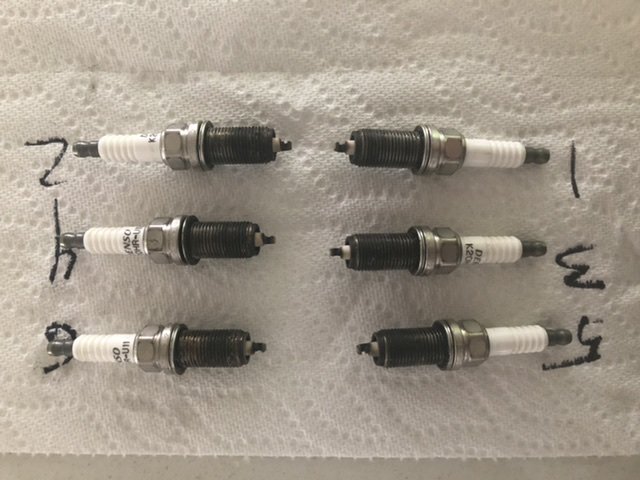

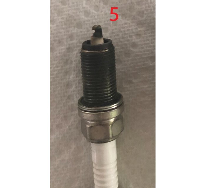

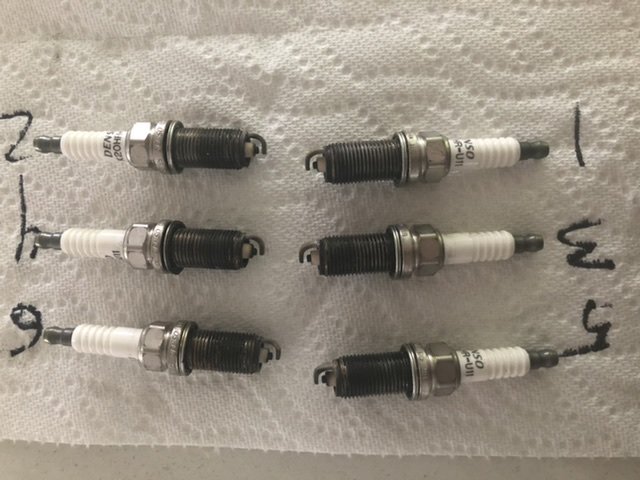

    210EF8A4-F3B9-4AEE-8B74-565234FD24F9.jpg Plans got changed and I was able to pull plugs today. What do y’all think?09F945E5-0A3D-46AC-A10C-93B242234471.jpg

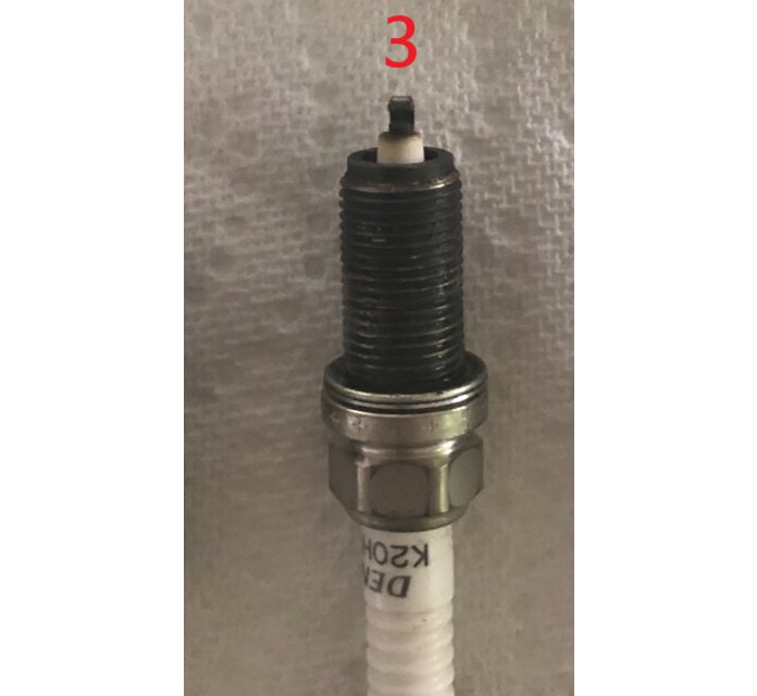

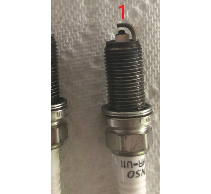

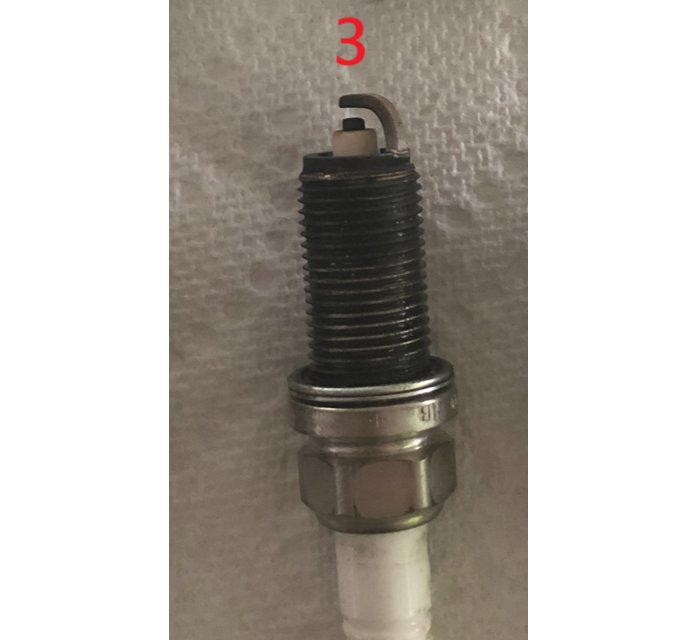

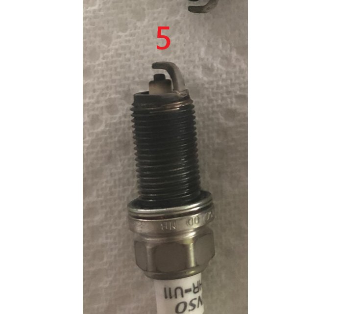

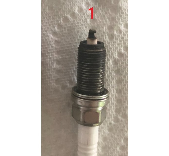

    Hard to tell. The plug in the cylinder with the blown gasket will be cleaner than all the rest.

    1.jpg 1-2.jpg 3.jpg 3-2.jpg 5.jpg 5-2.jpg Cylinder 3 looked cleaner than all the rest of them with the exception of cylinder 1. Cylinder 1 looked cleaner than all the others but not as clean as 3. These are close ups from the pics I posted yesterday. Plugs 2,4,6 look like plug 5
