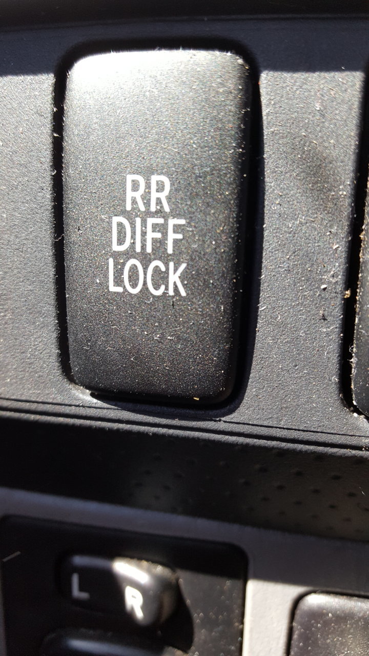

    You should see a white sticker on your 3rd member saying “lsd oil”. Typically the sport models came with the mechanical lsd and the OR came with a locking rear differential. Hope that helps

    If you have this button then you do not need the lad additive 20180918_130425.jpg

    This is true for 2009+ models.
    2008 and older had a mechanical lsd for sport

    Then you're good to go without the additive. I personally just use synthetic on the diffs.
