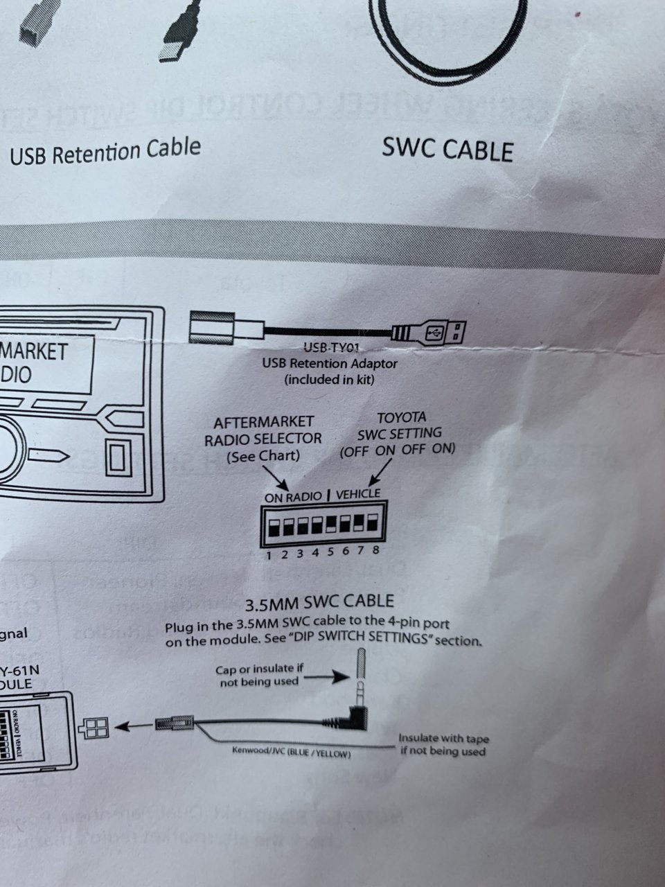

    Yes. Trying different dip settings. Here is what they show:

    Yeah so we want to go to the chart and look at pioneer on the top row.

    I’ve tried this way they show and they way you suggested with no luck.

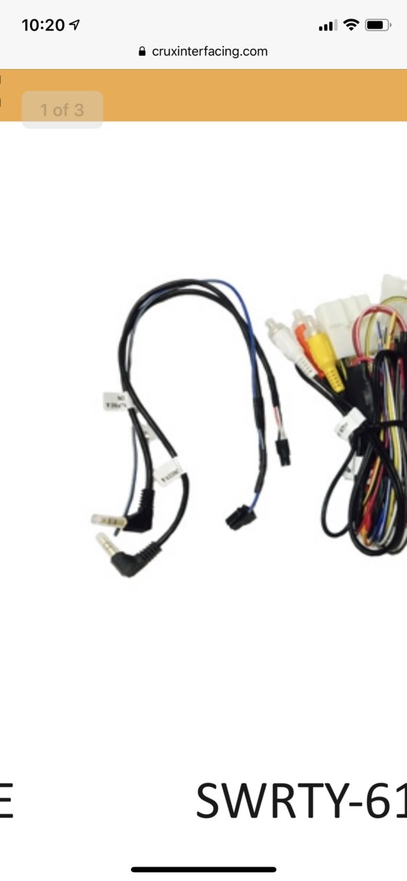

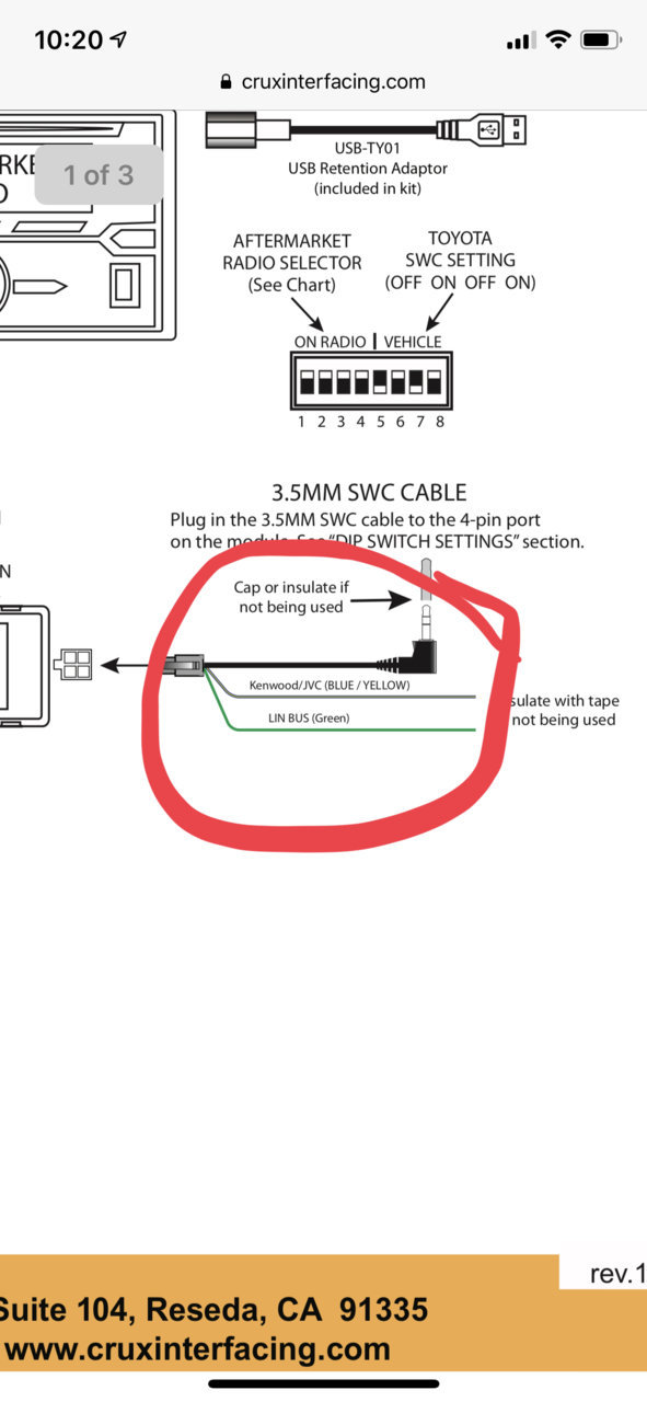

    The manual for that interface only says 2012-2017 Tacoma. I don’t expect that to be a problem, and probably just a non-updated manual. 2017-2019 should all be the same.
    It could be a defective module. It could be incorrect wiring. It could be a few things. Is there any type of LED on the module, perhaps that lights up when you first cut the truck on? Most modules have some form of light to indicate that it is receiving a button press from the steering wheel.
    It’s not going through the trucks data system so they aren’t “talking” to each other. As long as the vehicle section dip switches of the module are correct, it narrows is down to either defective module or incorrect wiring.
    One last thing
    The manual shows two different connectors
    But you want to be sure you’re using the one with the blue/yellow and green wires

    There is only one connector to plug in. I’ll have to check the color wire running to it. This could also be it. Connector is black going in. Don’t recall any light being on either.
