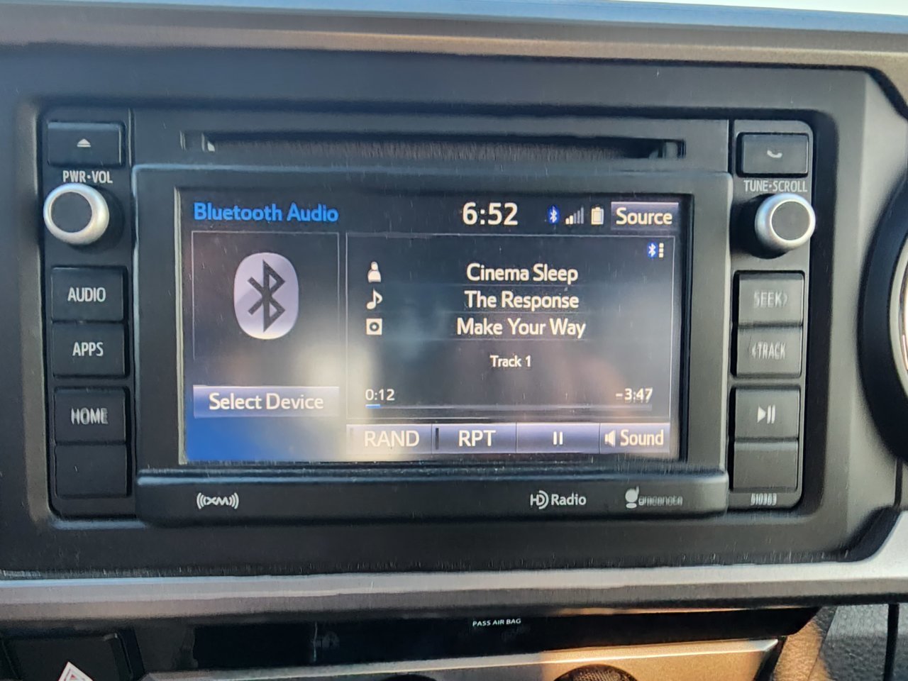

    Hi there I'm new here. And I've seen a few threads on aftermarket and OEM head units. But I'd like some recommendations for my specific situation. I have a 2018 tacoma SR5 and I would like android auto. Wireless preferred(unless it's advantageous to have wired) i could always get the wireless dongle if units without wireless are cheaper. Id like to not have to modify my dash trim, so basically plug and play(i know some come with adapters so thats okay). and I'd like to not be spending crazy money (like near 1k). Idk if that's asking too much but I'd like some input on yalls experience. Thanks in advance!
