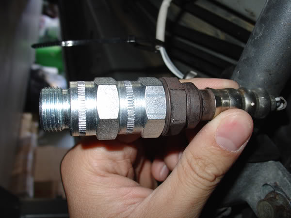

    Anyways, are you having any other conditions that may say you are actually having a problem? Fuel consumption, exhaust smell? If not, you can try a non-fouler. Autozone has them for about $5 each. They are use for spark plugs, but also used for O2 sensors to pull them out of the exhaust stream. Depending on which ones they have, you may have to drill the end of it out to open it up so the sensor can get enough exhaust to function.
