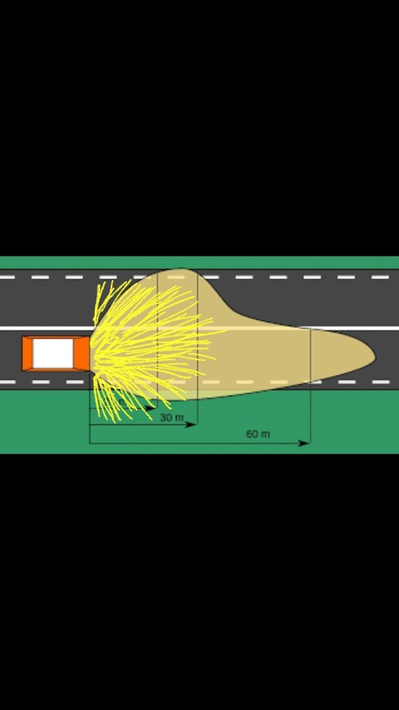

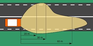

    Your headlights were designed to work with halogen bulbs. Due to the nature of filament style bulbs, the reflector is tuned to that that long 360 degree light source and focus it to a pattern that provides most light where you need it and less where you do not.
    A led bulb has a single or two diodes that produce a similar amount of light output in one specific spot in one specific direction. Because of this it throws similar amount of light in every direction. Which is not good since most people usually want to see further down the road than further into the ditch off the side of the road.
    Think of a halogen bulb pattern like a spear head. A led pattern would be like a round ball. Sure you can hit someone in the face with either and they will both hurt. But one is designed to do the job and the other just kinda works. Ill take the one that penetrates best and engineered for that use (halogen)
    Wicked scientific pics to backup my claims
    Halogen light pattern
    Led light pattern in yellow:
    Tldr; led if you want to be seen, halogen/hid if you want to see.
    I ran opt7 bulbs for a couple days until i saw a newly paved wet road and had to literally change my lights on the roadside. Ive run piaa leds for a year and only continue to because i have very bright halogen fogs for wet weather. Eventually ill go a proper retrofit n call it a day
    rlx02 likes this.
