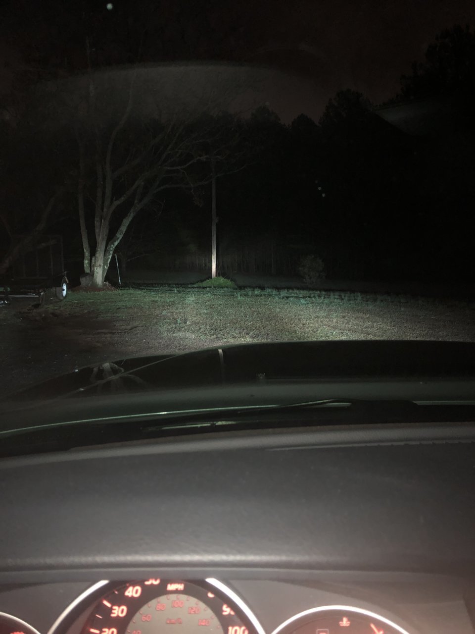

  9. Jan 21, 2019 at 9:07 AM
    se7enine
    se7enine MCMLXXIX
    Apr 18, 2013
    #102322
    15,899
    Reno, NV
    98 Tacoma SR5 Xtra Cab 3.4L
    Those shine high. Is that low beam?
  10. Jan 21, 2019 at 9:27 AM
    Babybluetaco
    Babybluetaco Well-Known Member
    Dec 9, 2018
    #275343
    898
    Austin
    Monroe, North Carolina
    09 5 lug
    That was hi beam sitting on top of a hill shining down a hill

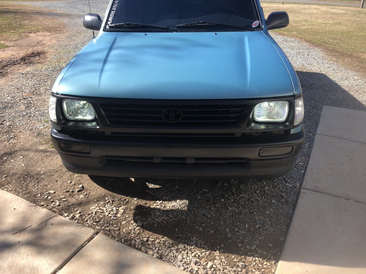

    I have sealed beam lamps. What did you replace the sealed beams with to install the LEDs in?
  12. Feb 4, 2019 at 5:16 PM
    Babybluetaco
    Dec 9, 2018
    #275343
    898
    Austin
    09 5 lug
    7x6 plastic housings off eBay. Go on eBay type in 7x6 headlight. Any of them that don’t have the bulb made into them will work

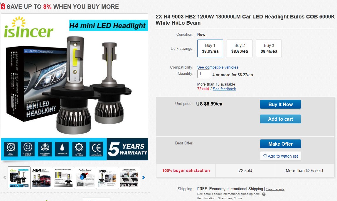

    Match it with the cheapest ebay LED bulbs you can find. 100k lumens set for $9.98 will do. There is no reason to pay more if you are going to put crap on your truck anyay.

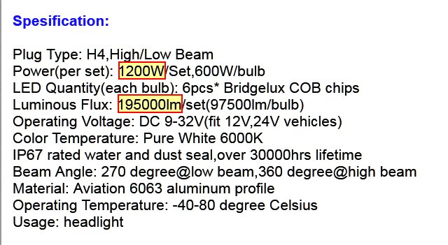

    Found you the best deal:
    Look how awesome bright they are: 600W per bulb (you need to upgrade your alternator for that) and 195 thousand lumens is more than a space shuttle during the take off.

    I think 1200 watts is a little over-kill! Having to by a much higher amperage alternator is a bit much. The sealed beam halogens are 55/65 watts! They just aren't enough when driving at night and all the newer vehicles headlights are blinding. I just want to be able to see, not blind anyone and get a hefty ticket in the process. I appreciate the advice, but there has to be a more moderate solution! lol!
