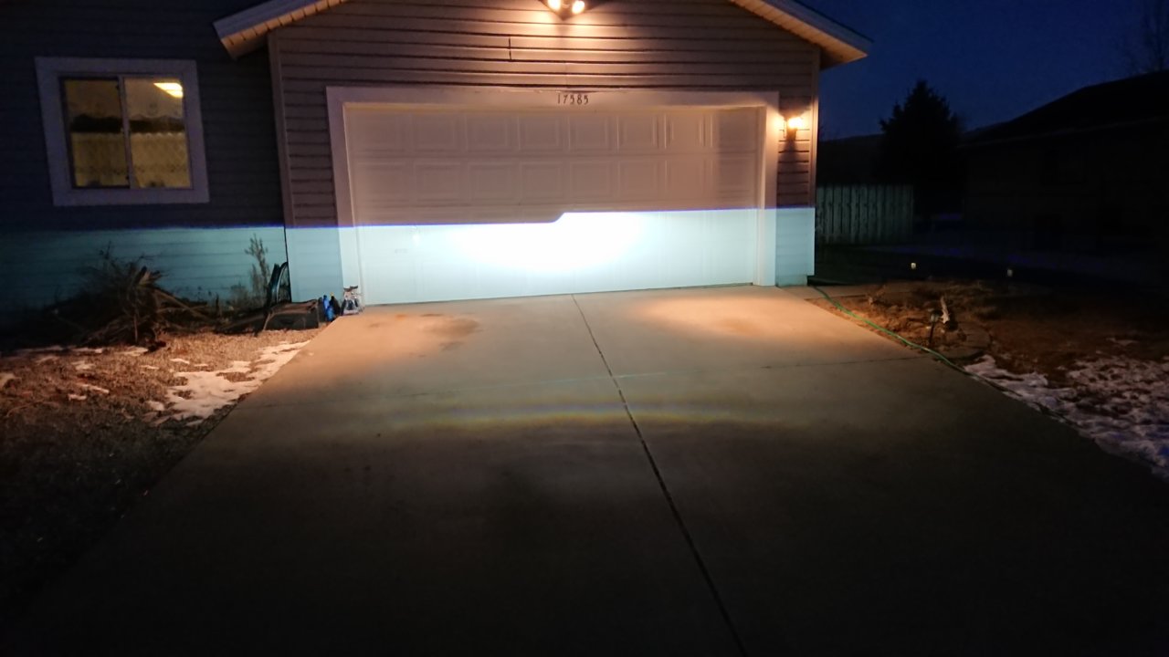

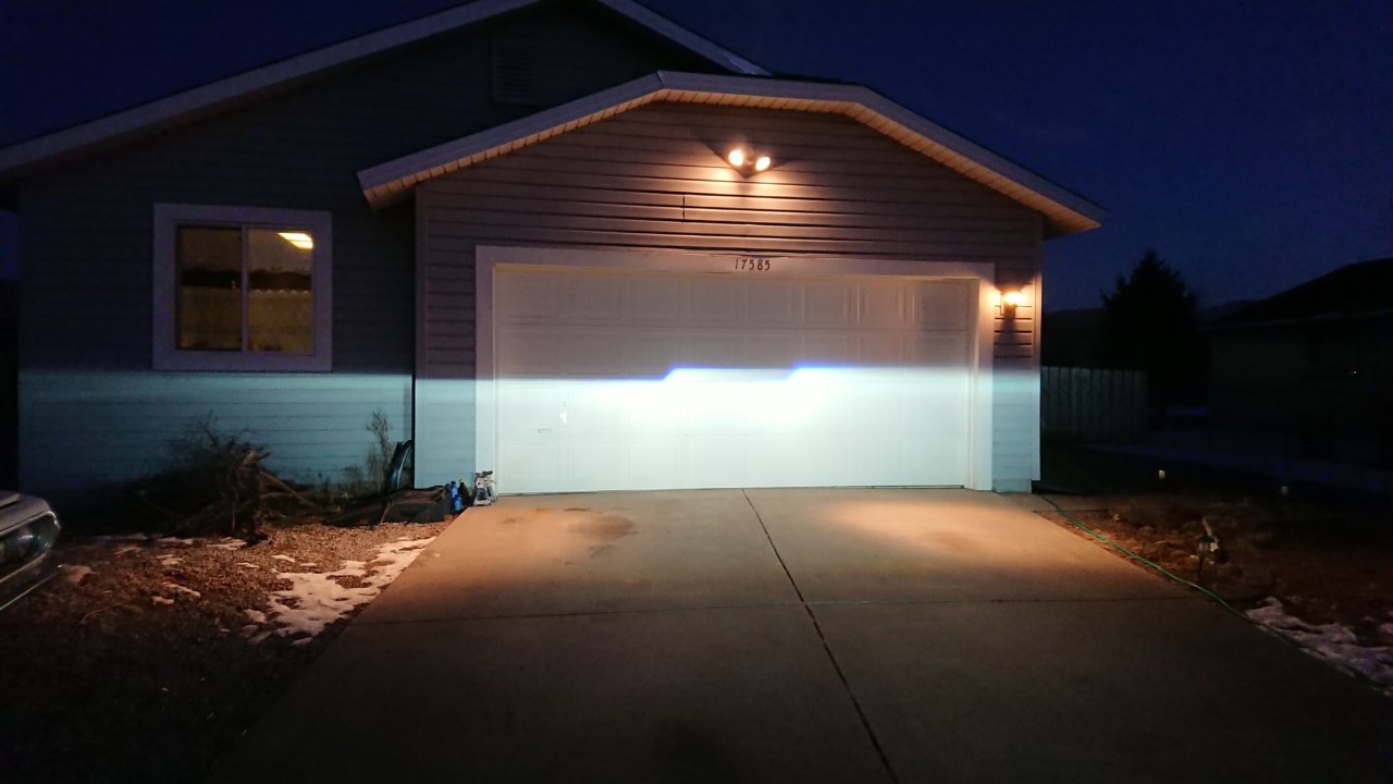

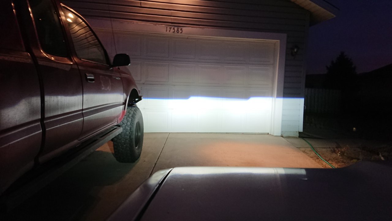

    I've got LED's in my garage that are similar in width and lumen as my HID projectors. They are just proving much harder to retrofit than a small MH1.
    HID
    LED

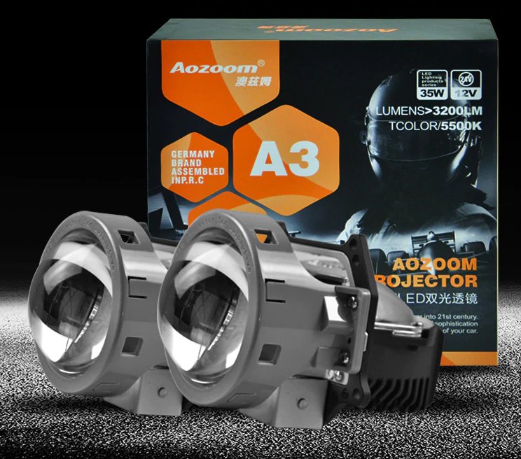

    The ones I'm waiting to retro are these
  11. Feb 5, 2019 at 8:55 PM
    #31
    tony2018
    tony2018 Well-Known Member
    Feb 24, 2014
    #123866
    5,288
    there seem to be similar products out there.
  12. Feb 5, 2019 at 8:57 PM
    #32
    se7enine
    se7enine MCMLXXIX
    Apr 18, 2013
    #102322
    23,446
    Reno, NV
    They have all copied Koito for the most part.
