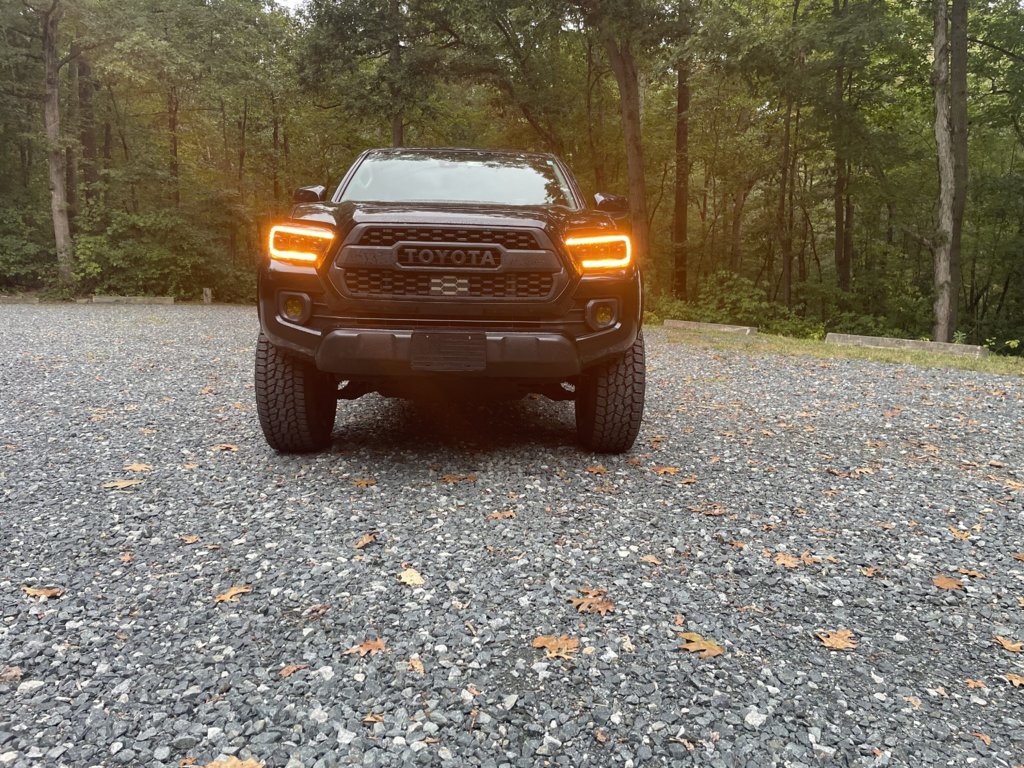

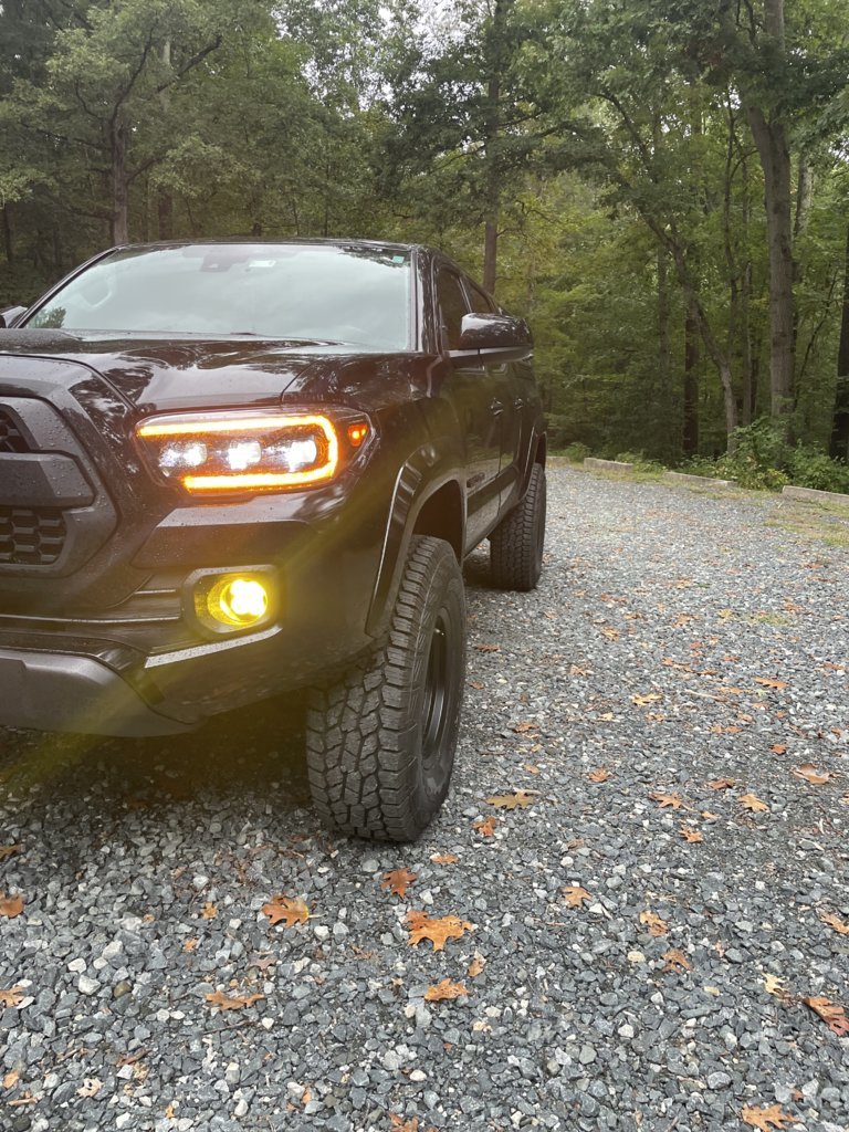

    I have Morimoto’s and I absolutely love them, I get tons of compliments about how good they look and they preform well also.
