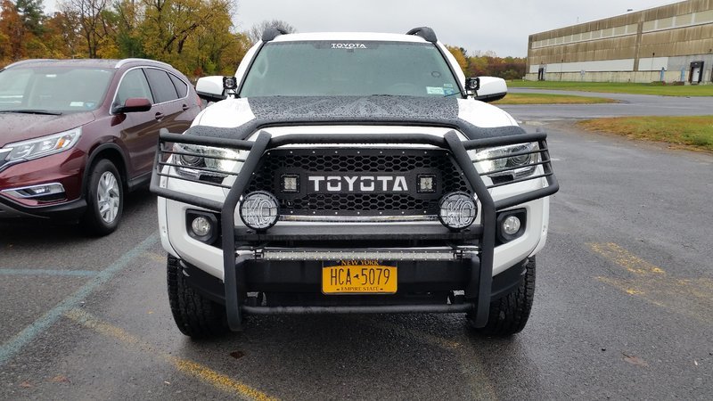

    Yes absolutely you will need the resistors the dictionals will flash fast thinking there is a bulb out lets see if the pic looks good20161020_155604.jpg

    Very nice! Nice truck also! What size ohm resistor did you use? Also would you happen to have the name or website that you got the resistor and bulb from? Thanks

    I have no frikin clue have all the wiring done by pros that have worked on sterio and other I install they wire. I am getting thos rigid cubes wired in the am I will ask them and get back to you bulds were installed at TINT WORLD while I was getting other work done

    They are only bright really in the night you can see it was really overcast yesterday and could only see them alittle better than the photo

    I am here at TINT WORLD near me and about to ask them what size resisters they installed on my SR5 with the switchbacks are 60olms 25watt
