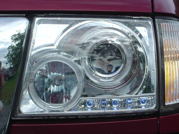

    jab - can you post a pic of your projector headlights?
    I searched everywhere for projectors and the only ones I found didn't look much different than regular crystal clear replacements... and they cost like 3 or 4 times more.

    Like I said mine is a 2000 model, not sure what is available for a 2002?

    Those clear w/ black corners are exactly what I got... except I didn't pay $200 (more like $70 haha) I think they will work out just fine
