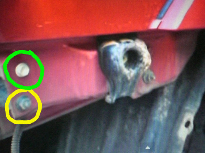

    dh920trd
    dh920trd Well-Known Member
    Dec 31, 2014
    #145276
    120
    david
    s.california
    the 4th bolt is circled in green. Make sure to take that bolt out and not the one below it circled in yellow. Found this out the hard way

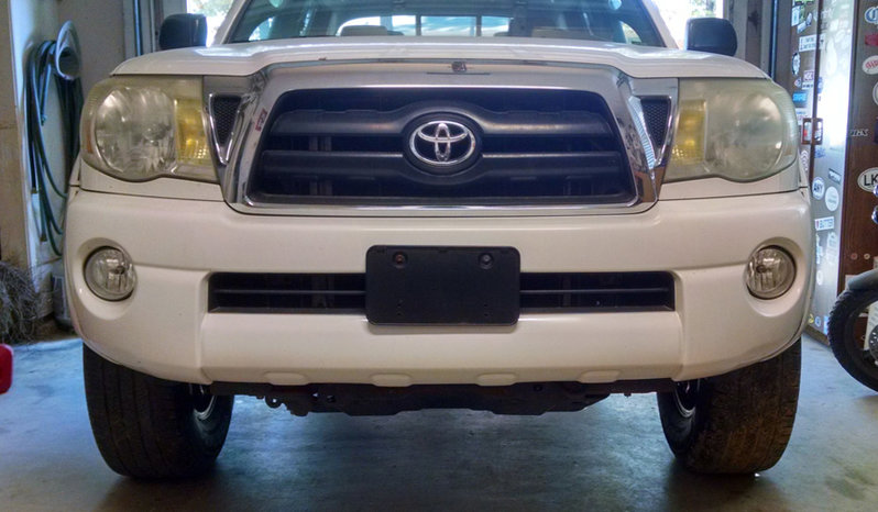

    Sambones80 Active Member
    Aug 23, 2015
    #162491
    25
    Sam
    Charlotte, NC
    2021 DCSB 4x4 TRD Sport

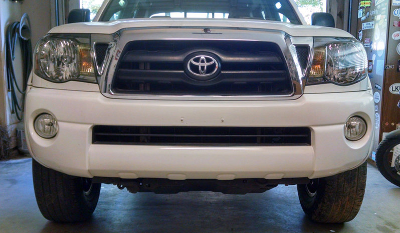

    Great write-up, I was able to find that last bolt no problem. I'm gonna need some of those push pins as well. A couple of mine are just MIA but what really pissed me off was that I broke one of the clips on the bottom of the grille. Anyway, the actual lights came out great. I was hung up on which aftermarket brand to get and then I stumbled upon some used OEM's on ebay for about the same price.

    Nice improvement. Good call on staying OEM.

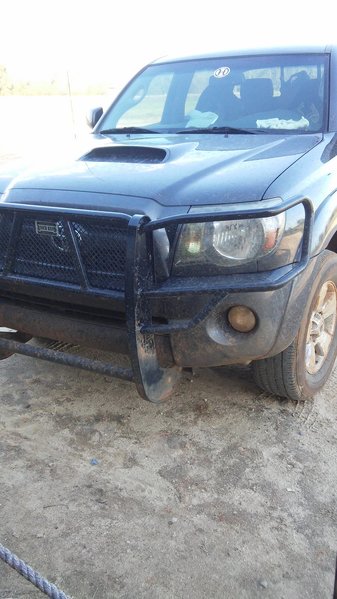

    Meatcutter Member
    Nov 28, 2015
    #170894
    9
    Layton
    2011 grey tacoma TRD sport
    Ranch Hand installed,HUD lights installed.
    Swapping out mine tomorrow! Not gonna paint them though. Thanks for so,ithe info on swapping then out. One question is, I have a Ranch hand grill guard on mine. Is that Hanna affect me taking the grill and headlight assembly out?

    I'm not familiar w/ that grill guard. I googled it, and it looks like it's designed to protect the headlights. The grill pulls straight up, so that should be fine. Not sure how close it comes to the headlights, but it may interfere when you try pulling the headlights out. Hopefully the design allows for enough wiggle room to get them out.

    I have a good 4-5" clearance from the grill guard to the headlight. It might be just enough room to get it out. Thanks for the response

    Waiting on fog lights to get in. Then swapping them out. My lenses on both the headlights and fog lights are cracking from the inside out. Toyota said there's no recall on them so the bill is on me if they fix them.
    And I sure will post some picks after install of headlights them with the fog lights swapped. And probably by then I won't be playing in the mud and have it washed as well :)

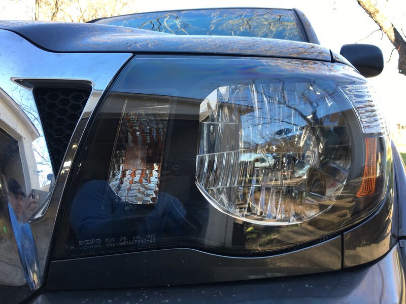

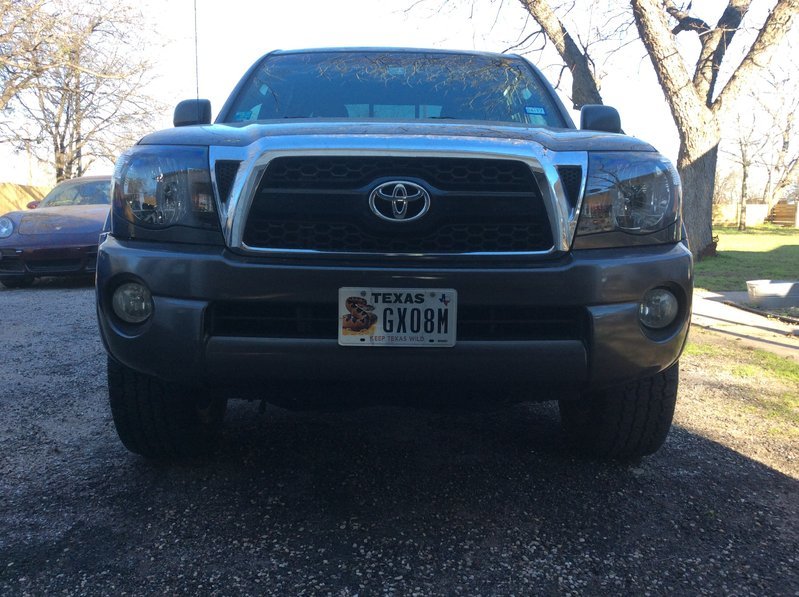

    #200
    WebberLander
    WebberLander Well-Known Member
    Apr 1, 2014
    #126706
    1,877
    Mark
    Colorado
    2011 SR5 4x4
    Overlanding Rig
    Thanks for this write up. installed a set of DEPO headlights with the black housings. Waiting for it to get dark so I can aim the headlights. I also sealed the beams with clear silicone to prevent moisture and glass coated the lenses so they stay new looking for a long time. Very happy with the look.
