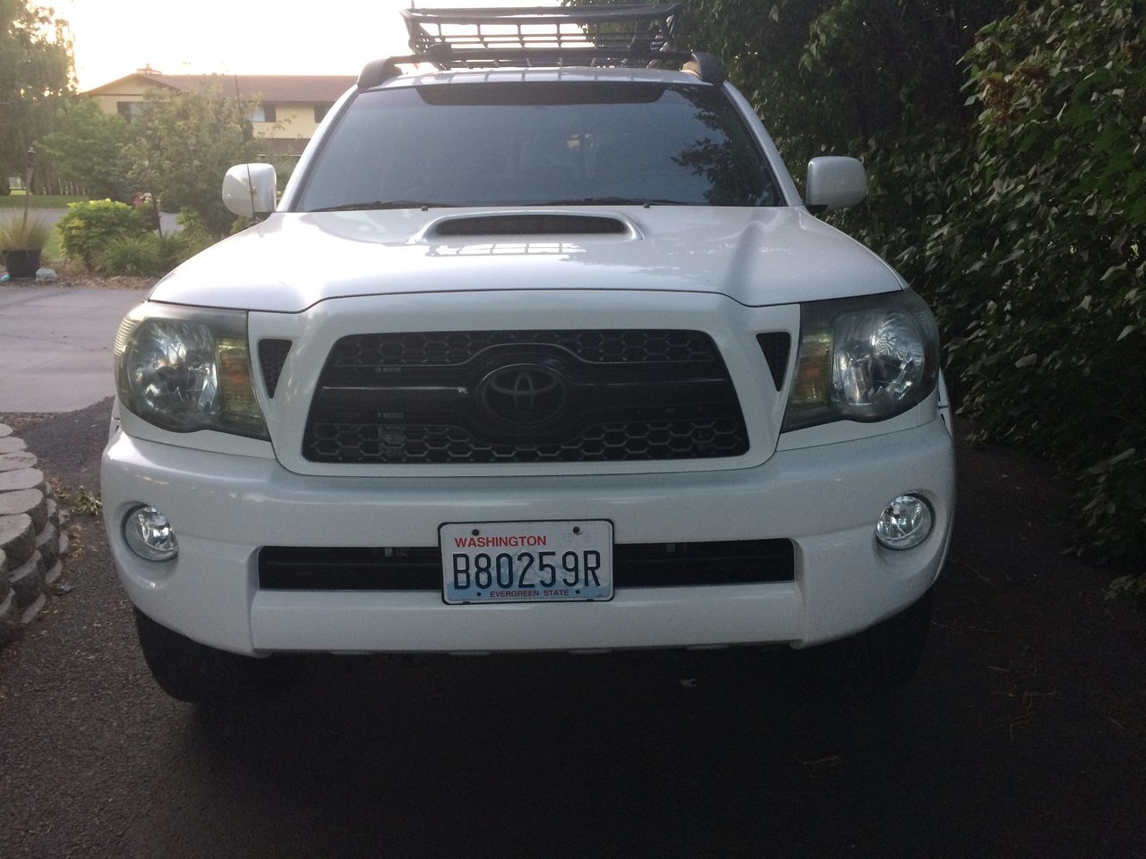

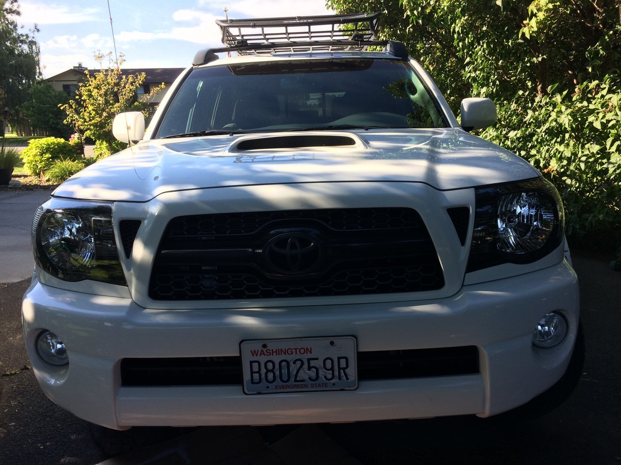

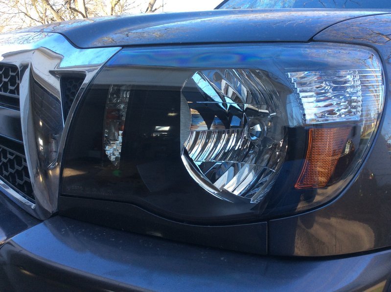

    That #!?¥&$ bolt is a pisser! For me it was the driver side. Passenger side I was able to get my hand with the 10mm rachet wrench pretty good but had to peel back the wheel well liner. Anyway before and after pics. Not sure if you can tell I went with the black housing.

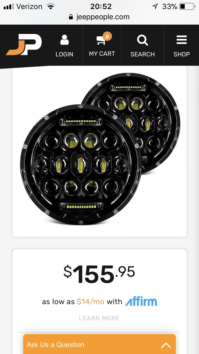

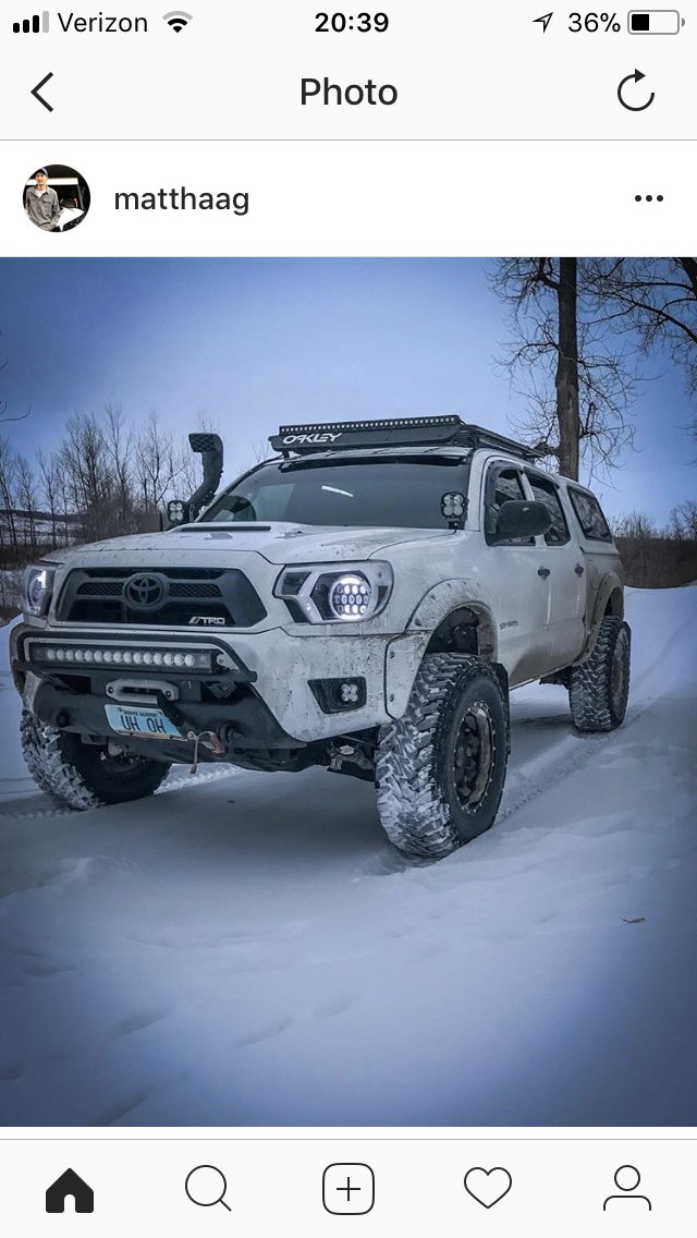

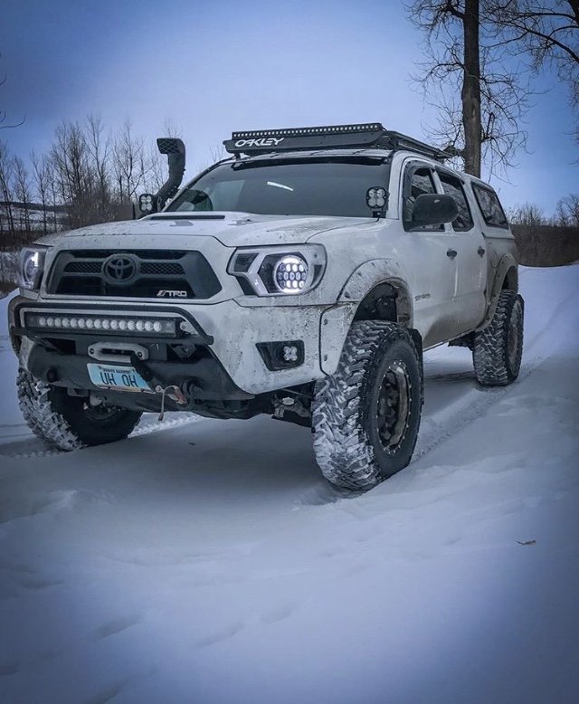

    1785DE09-11AC-426F-8360-B3A93A3BAB59.jpg FF45EBDA-9210-4372-84F3-290F1700029C.jpg Resurrecting an old thread, be prepared...
    so I just found a new mod I’m itching to do, retrofitting 7” Jeep led headlights into my headlight housings. I wanted to use oem headlights but I didn’t want to use my housing Incase something went wrong. I found a set of oem headlights off a 2005 on Craigslist for $50 that would work great for my application... I have a 2015. My question is, are all headlights 2005-2015 interchangeable? I know theyr different colors, but are all the bolts the same and everything? Any help is appreciated. Thanks in advance.
