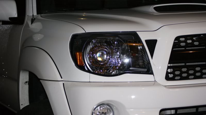

    I have it post in another thread but here it is.
    191494_10150121070156919_653121918_65598_6514a8916503ef4f35a93776ff816b36b13a2129.jpg

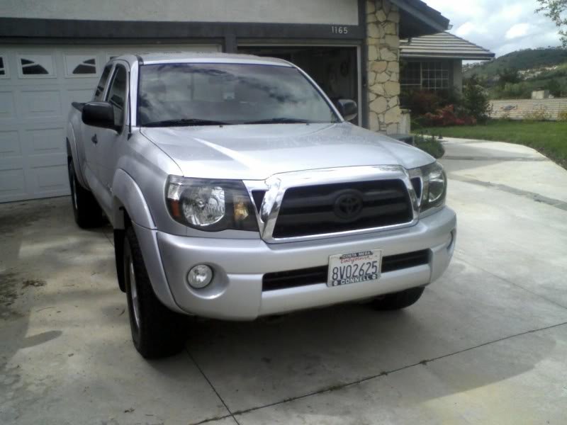

    Thanks for the help. I dont know if I would have ever found that 4th hard to get screw. Anyways this is how it turned out.
