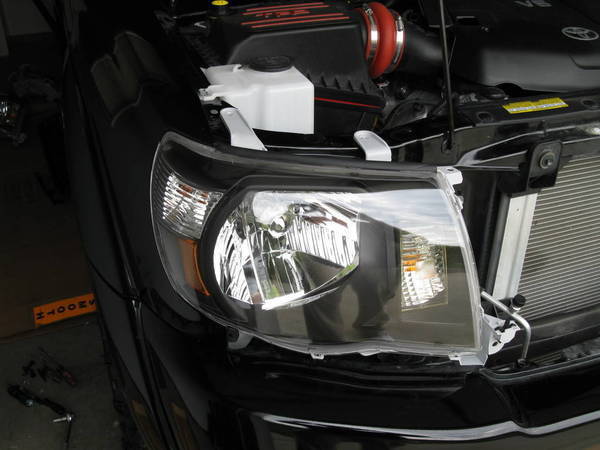

    DO IT, I just got my kit from theretrofitsource.com (5000 w/ projectors) and it has been popular on here. That's how I found out about it, I called and spoke to Nate who was very helpful. I just got my headlights disassembled last night and will be painting them this weekend. I will post pictures. I want that Krylon Orange stained spray that is impossible to find, like what Nightstr did to his lights that look great!
    Thanks Twony

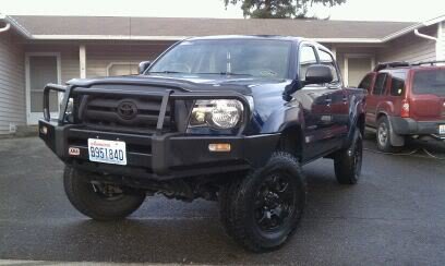

    Looks nice!
    I've been very happy with mine since I did it a few months back. I noticed you blacked out your parabolic reflectors for your turn signal/parking lights... are they still bright enough?

    Good pic Anthony!!
