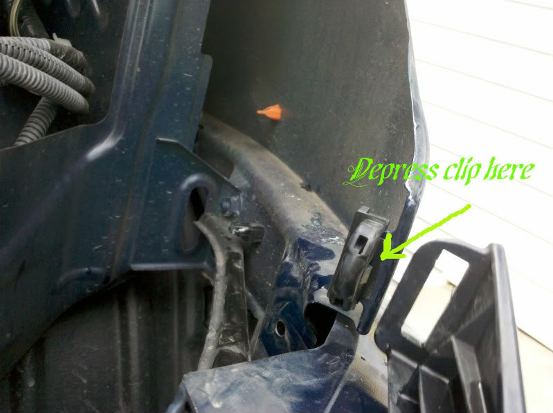

    Just wondering how you got that clip released on the trimpiece below headlight. I started to do the headlight removal and stopped because I thought I was going to break that trimpiece, couldnt get it off. Your pic shows it without the headlight in. how do you do it when its in?

    Just take a long flat headed screw driver. once the inside is loose, you can pull it away enough to stick the head of the screwdriver in there and depress the clip. I only took that picture w/ the light out b/c it was easier to show the process. It would've been tough to capture the clip w/ the light still in.
