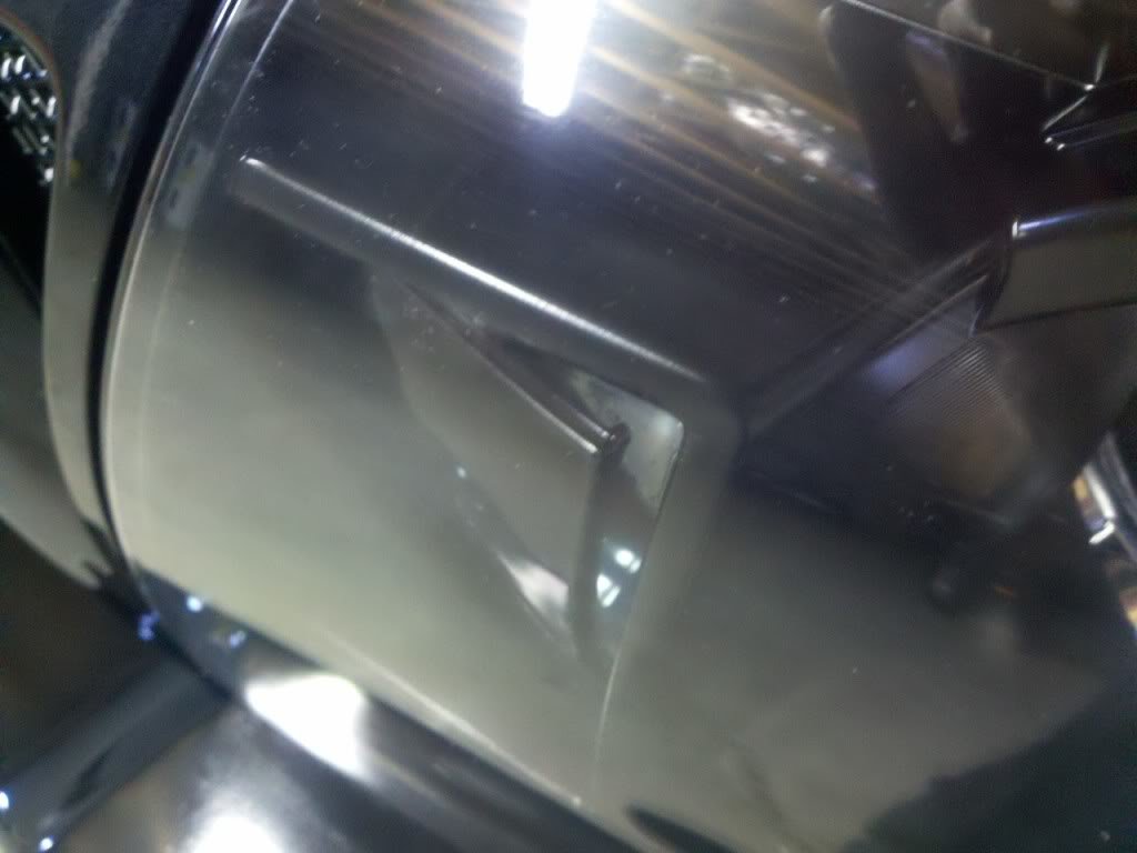

  8. Apr 24, 2012 at 11:41 AM
    #128
    monsterkx2fiddy
    monsterkx2fiddy Well-Known Member
    Mar 6, 2012
    #74357
    1,137
    Birthplace of Davy Crockett
    I hate washing my truck! All I find is new scratcheIMG_20120424_124142_d9591bfe4473c43f6ef36127fa4131a8a0e52832.jpgs and new problems.
    What do I have to do? Open it up pop it back on maybe use some glue? Then just reheat and put back together? Buttle should be good and plentifull
  9. Apr 24, 2012 at 4:53 PM
    #129
    monsterkx2fiddy
    Mar 6, 2012
    #74357
    1,137
    Help? Its been about 3 weeks and this just now happened.
  10. Apr 24, 2012 at 4:57 PM
    #130
    Toyota Tech31
    Toyota Tech31 Sometimes when I close my eyes, I can't see.
    Sep 2, 2011
    #62769
    10,369
    Jason
    Debary, Florida
    '08 SWB Bad ass SPORT
    Air Raid air intake, 40 Series Flowmaster Muffler, Front Turn Signals Now Turn And Park, KENWOOD HEAD UNIT W/ ALL KENWOOD SPEAKER UPGRADES AND 2-10" KENWOOD SUBS BEHIND BACK SEAT, Bilstein 5125'S In Rear W/ 1.5 AAL'S, Bilstein 5100 W/ Eibachs Up Front, LR Upper control arms, NFAB steps, Bruteforce Fab Hybrid front bumper, LP10000 SuperWinch, 2 Rigid Industries SRM-2's, OKLedlightbars 6 CREE LED lights as fogs, AVID RBG, 2 4" red ring HIDs mounted behind the grille.
    Do you want to save the lense thats loose? Or remove it?
  11. Apr 24, 2012 at 7:26 PM
    #131
    monsterkx2fiddy
    Mar 6, 2012
    #74357
    1,137
    i want to save it. where it aped the reflector off behind it. it pulled some of the chrome off. so i definetly need to save the piece
  12. Apr 24, 2012 at 7:27 PM
    #132
    monsterkx2fiddy
    Mar 6, 2012
    #74357
    1,137
    i just thought of something. anyone know of a place where i can get a small suction cup on a stick? think thatd work? that way i dont have to reopen?
  13. Apr 24, 2012 at 7:48 PM
    #133
    Toyota Tech31
    Sep 2, 2011
    #62769
    10,369
    Jason
    Debary, Florida
    with saving it, i'm not the guy to input on that, but i have a killer technique for removing it without taking apart the whole assembly. Sorry i cant be of more help to you. Good luck though.
  14. Apr 25, 2012 at 4:06 AM
    #134
    95SLE
    95SLE Starting to get cold outside
    Aug 5, 2009
    #20718
    12,212
    Tom
    Maryland
    09 RWD Access Cab
    Custom XM Install, Window Tint, Intermittant Wiper Install, AVS Bug Deflector, Bed Mat, TRS FX-R retrofits, CIBIE fog and spot lamps, PIAA 510 lamps, Acess LE cover, Weathertech Digital floorr mats, LED interior lighting, Pioneer AVH-2300BT HU, Boston Acoustics speakers, JL Audio Amp, shorty antenna, leather wrap steering wheel cover, Viper security system.
    You will need to open it back up to put the lens back in place.
    One of those things that you just need to suck it up and do it.
    When you pu tthe lens back in you might want to use a dab of clear silicon caulk to secure the lens. I sort of wish that I did after reading the posts about the lens falling out after reassembly.

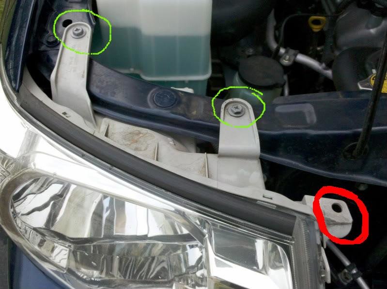

  20. Jun 21, 2012 at 12:20 PM
    #140
    Oregon TRD
    Oregon TRD "GO DUCKS" Edition
    Oct 16, 2007
    #3081
    15,316
    Ross
    Steel Panthers bathroom floor!
    2005 Mall Krawler
    6" Fabtech Lift, 35" Fierce M/T 17" Eagle Alloy Sim bead locks Naked girls in the bed 10.1" DVD head unit Two 7" Headrest Monitors PS2 in glove box
    Quick help anyone!!!!
    When I went to put my headlights back in, the red circled part BROKE!!!!!!!!!! OFF!!!!!!!!!!
    Gorilla glue? Super glue? WTF!!
    I was squeezing the black plastic clip thingy in and it snapped off.....cheap ass plastic.
    I've removed my headlights 4 different times and I guess enough was enough. Will gorilla glue work? I've never used it.
    I ended up putting the black clip thru the holes just to hold the piece in and the grill isn't loose or anything. I just don't like having anything broke.:(
