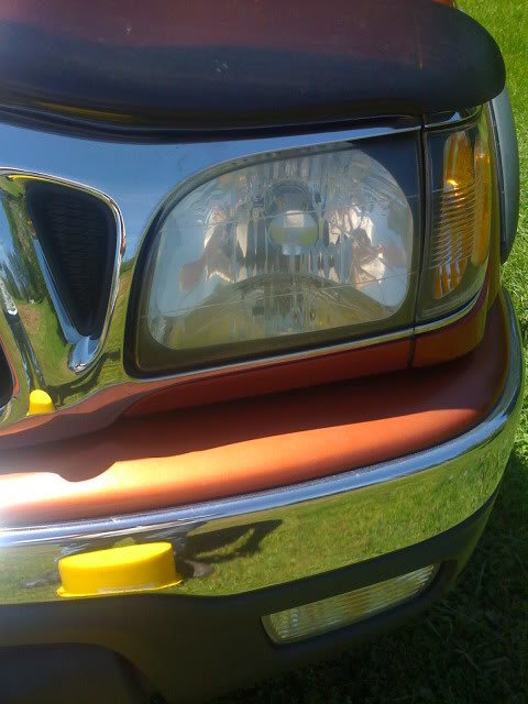

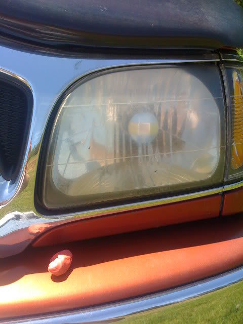

    Ok, i was a bit bored earlier and took out my Zaino clay bar for some fun.
    Before:
    I used Meguires Spray Detailer as a lubricant instead of a degreaser like I normally use. I took about 10 minutes on each headlight rubbing away with the clay bar until everything was very nice and smooth.
    After:
    There's definitly a noticible difference. It might not be as great as a full kit or sanding, but it looks a hell of alot better. I'll have to see if I notice a difference or not at night.
