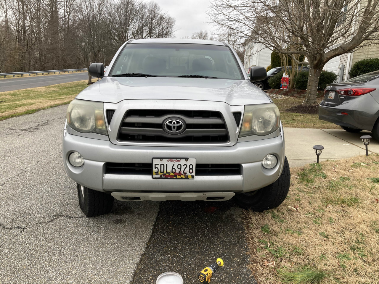

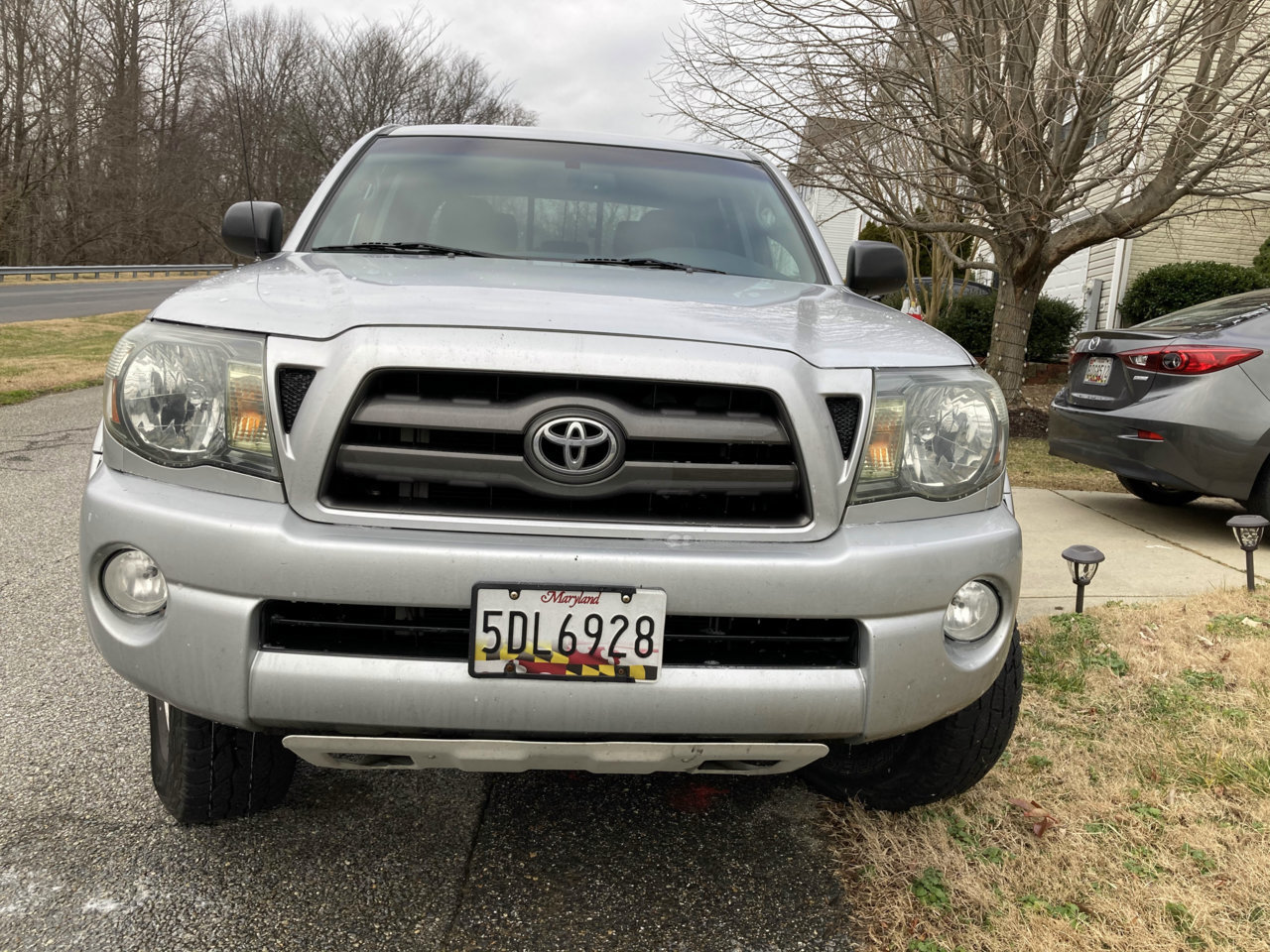

    This has probably been covered on here before but I wanted to post a few pictures of my headlight restoration (if you want to call it that) from today.
    I saw this video and decided to give it a try myself: https://www.youtube.com/watch?v=dsyUgXKdXu0
    I didn't even do every step in this video. All I did was buy some sanding discs for my drill. https://www.amazon.com/gp/product/B01M5EYXML/ref=ppx_yo_dt_b_asin_title_o04_s00?ie=UTF8&psc=1
    Then dipped those discs in soapy water and grind away at the headlights for several passes each and it made a huge difference. Rinsed them off and all done! Took maybe 20 minutes tops. Here are the before and afters:

    Definitely an improvement. Don't be surprised if the haze comes back though... it pretty much always does. If you keep them waxed then it'll help keep 'em clear longer. Or go full bore and sand 'em down even more and refinish with an automotive quality clear coat (plus keep them waxed) if you want them to stay clear for years and years to come.

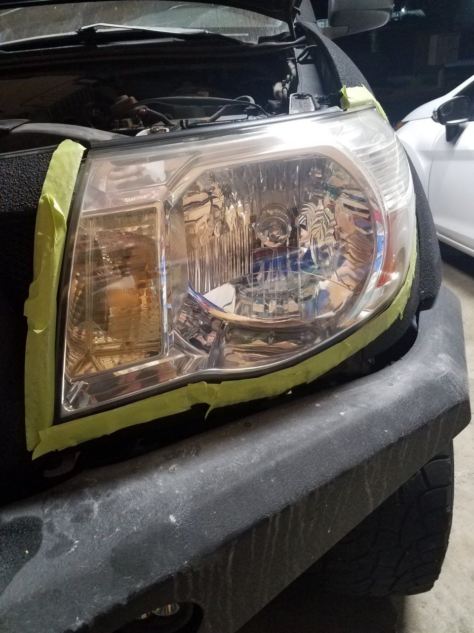

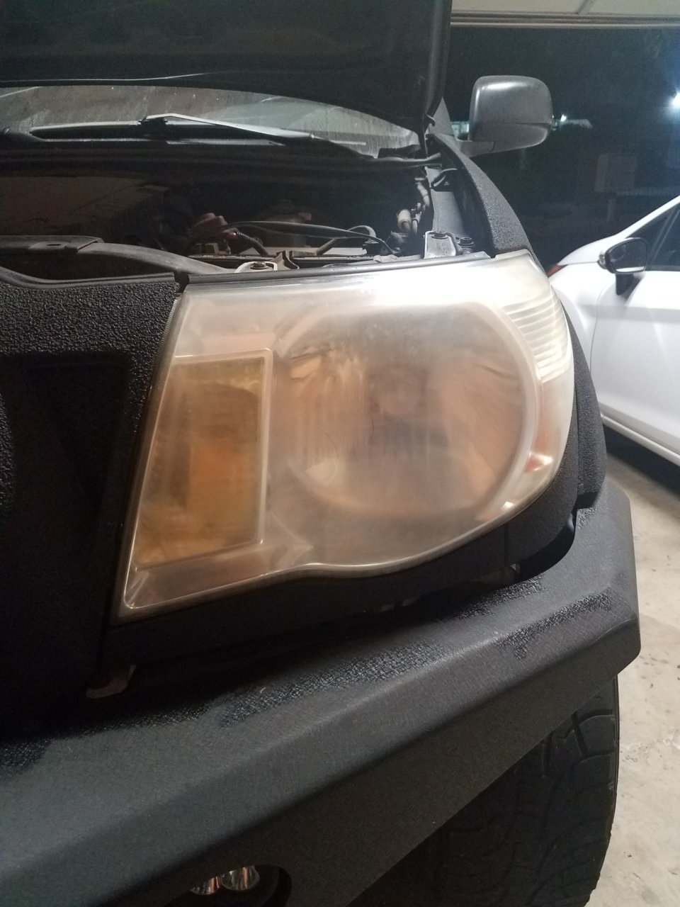

    Used this kit last night. Worked pretty well on my 08. The hand buffing with "head light restore polish" wasnt cutting it anymore and still left a yellow hue/haze.

    Before and after pics... forgot to add that I used plenty of water while using the discs but that white oxidized substance made my garage floor really slipper/slick. Highly recommend a good sweeping after the water has dried.
